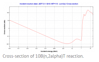

I think this reaction is considered to be threshold because of its cross-section:
Figure of reaction cross-section.
But does anybody know, why the reaction cross-section have a threshold at 1.2 MeV??
Can it be derived from some reaction kinematics or it is "simply" some quantum behaviour of 10B nucleus??

Look at the reaction cross-section and energy for 10B(n,α)7Li and also the binding energy of 7Li <-> T + α.
What energy is necessary to dissociate 7Li into T + α?
It's a QM thing. There is both total energy (kinetic and rest mass) and momentum to consider.

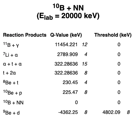

This comment was not well constructed originally by me. The original question was about the equivalence of the terms "endothermic" and "threshold reaction" using the reaction ##^{10}B(n,2\alpha)^3H## as an example. And then I muddied the waters by using a different reaction, ##^{10}B(n,\alpha)^7Li## as an example. Sorry about this.
The answer is, "yes" -- endothermic and threshold reaction are completely equivalent. They are each statements of the fact that the reaction requires energy to proceed. Endothermic refers to the (non-zero, positive) amount of energy required in the center of mass frame. "Threshold reaction" is the same statement but the implicit, perhaps, assumption is that we're talking about the projectile energy in the lab frame.
For the reaction ##a + A \to b + B##, the center of mass energy for the threshold reaction "to go" is: ##E_c > Q##, where ##Q = m_a + m_A - (m_b + m_B)##. In the laboratory frame, where the target "A" is at rest, the projectile energy must be: $$E_a = \frac{-Q(2m_{aA} + (-Q))}{2m_A}.$$ Here, ##m_{aA} = m_a + m_A##.
I'm not sure where the figure in the OP with "##E_k > 1.2 MeV##" comes from but it is incorrect if we assume that ##E_k## is the energy of the neutron in the lab frame (with the ##^{10}B## at rest). The attachment generated here) shows that the correct value for ##Q_{^{10}B(n,2\alpha)^3H} \approx 0.322## MeV > 0, meaning it is both exothermic and not a threshold reaction.
