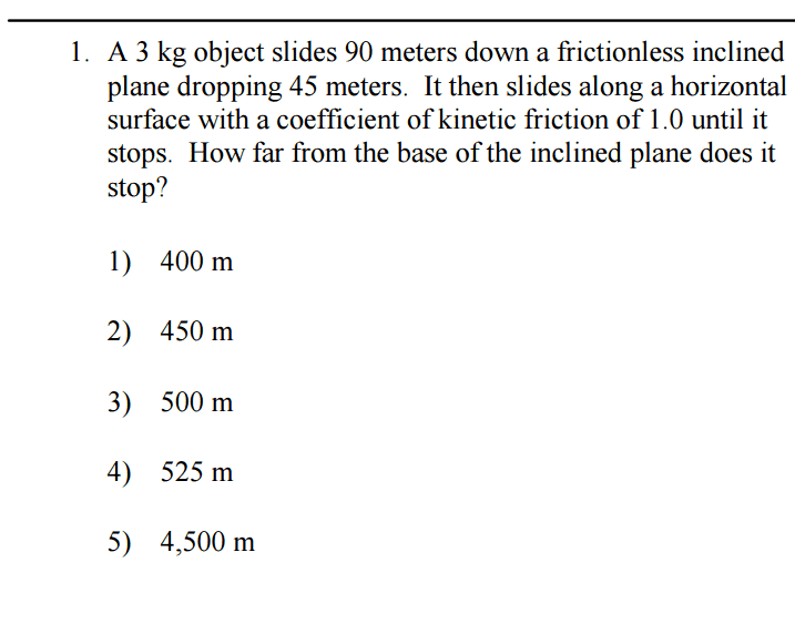

The block has potential energy U at the top of the ramp, and this is transferred to kinetic energy K at the bottom, which is then trasnfered to work done by friction, Wfr.
U = K Conservation of energy
K = Wfr Conservation of energy
g = 10 m/s2
U = mgh = 3*45*10 = 1350 J
1350 J = Wfr = Ffr * d = m*g*u*d = 3*10*1*d
1350 = 30*d
d = 45 m
This does not match the answers. Am I doing anything wrong?
Your calculations are correct. There is likely an error in the problem statement. I suspect that they intended the coefficient of kinetic friction to be 0.1. Your answer of 45 m is correct for the given information.
That is a very good point. We usually don't see coefficients of friction to be 1.0, so it probably was 0.1. I just wanted to make sure my understanding of work-energy relationship was correct. Thanks!
