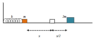

A block of mass m is attached to a spring with a force constant k, as in the above diagram. Initially, the spring is compressed a distancex from the equilibrium and the block is held at rest. Another block, of mass 2m, is placed a distance x/2 from the equilibrium as shown. After the spring is released, the blocks collide inelastically and slide together. How far (Δx) would the blocks slide beyond the collision point? Neglect friction between the blocks and the horizontal surface.
At first I thought that this question is very easy.But now I don't know how I should break the problem up such that I can write neat equations for momentum and energy conservation.
should I consider the intermediate position when m reaches its equilibrium position and its energy is purely kinetic ? the question asks for delx but the equations contain only velocity terns and why will it even stop post collision there is no friction?

I wouldn't worry about the equilibrium point. So, what is the key stage in the motion after the block is released?
the inelastic collision .
but the kinetic energy is not conserved during such a collision.
so should I write an equation just before the collision and will m's velocity be the same at x/2 (pre collision) as it was at position x
You're forgetting that the spring will pull the block back after the equilibrium point.

Not sure what you are saying there, but it doesn't sound right. You do not need to get to the point where anything has a leftward velocity. You are only interested in how far the blocks get before anything goes to the left.
The question is a little unclear. Do the blocks stick together or merely collide without bouncing at all? I think it means they stick together, otherwise they would start to separate immediately, even though there is no bounce.

Yes.
... and will m's velocity be the same at x/2 (pre collision) as it was at position x
No.
Use conservation of energy to determine the velocity of block of mass m immediately before the collision.

It won't go back and forth before hitting 2m. If 2m were not there, how far would it go before going leftwards at all?
The question asks how far they go "beyond the collision point". That is, how far before reversing direction.

The problem statement says that the block of mass m is attached to the spring.
Likes REVIANNA

It says the block is attached to the spring. If it wasn't attached it would be jettisoned at the equilibrium point. But, it is attached so it stays attached.
Although you may want to calculate the velocity at the collision you don't have to.
As Haruspex says, the blocks must stay stuck together after the collision.

so m will go beyond x , collide with m2 at x/2 , stick with it, and then they both move forward .
we have to calculate how far before spring pulls them back
I wrote an equation with equilibrium as 0 position
and equating the initial potential energy of m (##0.5kx^2##)and the final potential energy of 3m (##0.5k((x/2)+(Δx))^2##)
but I don't get the correct answer on solving this quadratic equation
we have to calculate how far before spring pulls them backI wrote an equation with equilibrium as 0 position
For the inelastic collision:
There will be a loss of kinetic energy. Right?
Likes REVIANNA
first I considered the situation b/w the launch and the collision
here the mechanical energy is conserved.
It gets converted from purely potential to partly kinetic and partly potential(because it moves past the equilibrium point )
I used this to find the velocity of m right before the collision
during the INELASTIC collision the momentum is conserved(because of negligible internal forces) and energy is not
I found the velocity of (now) 3m right after the collision
then again 3m moves further out until it gains max potential energy
we know that the post collision -part K.E and part P.E gets converted wholly into potential energy
the displacement after the the collision gave me the answer . thanks everyone!
