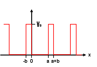

In Kronig-Penney Model we seek solutions for time independent Scrödinger equation inside and outside of the periodic potential.
for 0 < x < a;​
V(x) =
V0 for -b < x < 0​
My question is why solution of the KP Scrödinger equation in the region of [tex] -b < x < 0 [/tex] doesnot have complex exponentials as in the region of [tex] 0 < x < a [/tex] ?

The solution to this 2nd order ODE is a linear combination of exponentials (with real arguments). If you think about it physically, the wavefunction will also decay in this area, which can only happen if the argument of the exponential is real.

OK, so what about first region?
[tex]
\frac{{d^2 \psi }}{{dx^2 }} = q^2 \psi,
[/tex]
where
[tex]q^2 = \frac{{2m\left( {E} \right)}}{{\hbar ^2 }}.[/tex]
Isn't it also 2.nd order ODE ?
In the region with V=0 we have
[tex]
\frac{{d^2 \psi }}{{dx^2 }} = -\hat k^2 \psi,
[/tex]
where
[tex]
\hat k^2 = \frac{{2m\left( {E} \right)}}{{\hbar ^2 }}.
[/tex]
Solutions are traveling waves (going left and right).
Oh i see, I had some conceptual errors on writing the wave eq.
Thanks!

So we have different wave solution for V0 region and 0 region,
[tex]\psi_{1}(x)=Ae^{ikx}+Be^{-ikx}\ \ \ \ \ \ \ for \ \ \ \ \ \ \ \ 0<x<a[/tex]
[tex]\psi_{2}(x)=Ce^{qx}+De^{-qx}\ \ \ \ \ \ \ for \ \ \ \ \ \ \ \ \-b<x<0[/tex]
After we apply the boundary conditions (usual QM boundary condiions in in square well potentials ),
[tex] \psi_{1}(0) = \psi_{2}(0) [/tex] and [tex] \psi_{1}'(0) = \psi_{2}'(0) [/tex]
[tex] \psi_{1}(a) = \psi_{2}(-b) [/tex] and [tex] \psi_{1}'(a) = \psi_{2}'(-b) [/tex]
Then, we have four equations
[tex]A+B=C+D[/tex]
[tex]ik(A-B)=q(C-D)[/tex]
[tex]Ae^{ika}+Be^{-ika}=(Ce^{-qb}+De^{qb})e^{i\alpha(a+b)}[/tex]
[tex]ik(Ae^{ika}-Be^{-ika})=q(Ce^{-qb}-De^{qb})e^{i\alpha(a+b)}[/tex]
Determinant of the coefficients of this equation system mush vanish to have solutions. Than determinant yields,
[tex]([q^{2}-k^{2}]/2qk) sinh(qb)sin(ka) + cosh(qb)cosh(ka) = cos (\alpha(a+b)) [/tex]
