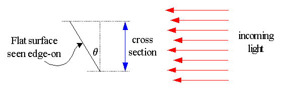

You might just have to derive your own relationship. Light from the Sun at our distance from it is essentially parallel light rays. Consider a flat surface that's tipped at an angle to the oncoming flux of light. The light that falls on that surface is the light that passes through some cross section that is perpendicular to the oncoming light:
How does the area of that cross section compare to the area of the tilted surface?

Would the cross sections area be smaller than the area of the tilted surface?
You should be able to deduce that from the geometry in the image that I drew. What's the trigonometric relationship between the height of the cross section and the edge length of the surface shown?
Cos (theta) = adj (Height of cross section) / hyp (length of surface), correct?
Correct. So given that the width of the surface presented to the light is not affected by the tilt angle (the width being the dimension of the surface that is going into the page in the drawing, and not seen edge-on), how does the area of the cross section compare to that of the surface?
Would the area be the same?
The same as what?

The cross sections area being the same as the area of the tilted surfaces width face. Was that the question you were asking? I may have read your question wrong.
No, I'm asking how the area of the flat surface compares to the area of the cross section. For a rectangular surface the area is L x W (length by width). The width of the flat surface presented to the light is unchanged by the tilt, but the length that is presented in cross section has changed by the amount that you worked out a few minutes ago.
In other words, what is the area of the cross section?
