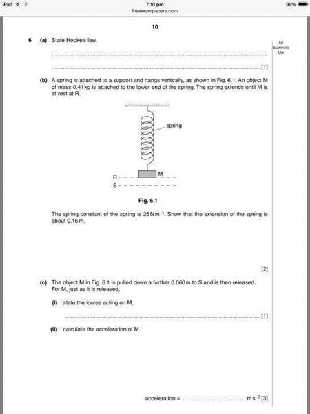

For part d) of this question, I don't understand "stretching/extension reduces and velocity increases/height increases" .
Hooke's Law: F=kx
Ok, so if extension is reduce, then force reduces too. Then how does a decrease in force causes the velocity and height to increase? Does it have something to do with the principle of conservation of energy, where a gain in kinetic energy equals to a lose in gravitational potential energy?
At a point lower than R , how does spring force compare to force of gravity ?
Spring force is more than the force of gravity .
So as long as mass is below R , acceleration is ( +ve or -ve ) ? And therefore velocity will always what ?
Positive..? I'm not sure.. Therefore, velocity will increase?
Yes . ( kx - mg = ma ) , kx > mg .
Now , a = dv/dt . As a is always positive till before R , dv is always +ve , and hence velocity will increase till R .
Hope this helps .
Hope this helps .
But how do you know that a is always +ve till before R? And why height increases? Does it got to do with 1/2 mv^2=mgh (gain in kinetic energy=lost in gravitational potential energy) ? And thanks by the way. :)
Janiceleong26 said:
But how do you know that the a is always +ve till before R?
I thought we agreed that -
It rises because acceleration is upwards . And that's pretty much the only reason .
Qwertywerty said:
I thought we agreed that -It rises because acceleration is upwards . And that's pretty much the only reason .
Yeah, I agreed to that one. But the mark scheme also states that the height increases as well. Why?
Likes Janiceleong26
OK thanks
