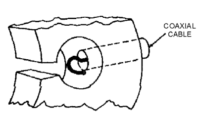

I don't think it is true that an EM wave leaves the magnetron, but rather, an alternating current is generated by the magnetron and is usually delivered via a coaxial probe.

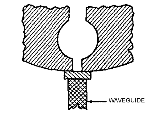

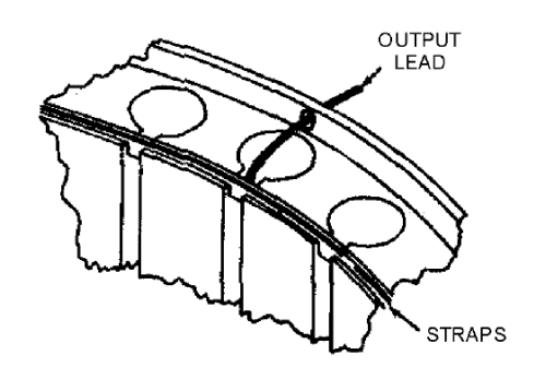

yes, RF is usually taken from one of the cavities via a probe and fed to the main waveguide that opens up into the oven cavity or WG feed to an antenna ( depending on specific use)
but it can also leave directly from one of the cavities and into the external waveguide
a couple of examples
the first 2 examples use probes
the third example has waveguide coming directly off one of the cavities
Naval Training Manual
http://www.phy.davidson.edu/instrumentation/Files/NEETS/Mod11 - Microwave Principles.pdf
this is from the above link that @scottdave suppliedthe ol' saying, " there is always more than one way to skin a cat "Dave
