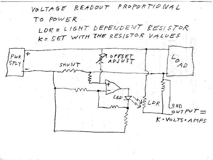

Here is a schematic for an analog readout Power Meter. The frequency response is limited by the response time of the LDR and the OpAmp. When powered with the same power supply, the OpAmp must accept common mode input voltage down to the negative supply.
Component values are left as an exercise for the reader. :frown:
The LED brightness is proportional to load current and the LDR varies its resistance in response. The LDR, being referenced to the Load Voltage, thus acts to multiply the Load Voltage by the Load Current at the circuit output terminal.
The OFFSET control is to bias the LED on at zero Load Current so a negative current can be sensed.
