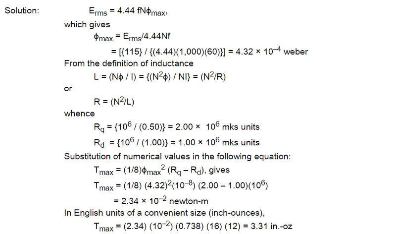

I'm quite new to these chapters and I can't seem to get my head around the theory and especially this question. That's the solution above. Where does the T_max = 1/8... equation come from? I understand that the mechanical work done in this system is the torque. And the derivative of work is power. I'm quite confused
I got an answer by:
computing difference in stored magnetic energy as i/2/2 x (Lmax - Lmin))
and equating it to work done by torque over 90 degrees of rotor angle.
To compute i I used v = iωL.
I used the average value of L over the 90 degrees.
I can't really justify using averaged L, nor why the result should give max. torque rather than averaged. But maybe you can use this as a guide. My answer was 12.5% high.
(Were you given some kind of formula relating max. torque to Φmax and delta reluctance? You could compute Φmax from v = N dΦ/dt = ωNΦ. Realize that all these formulas are approximations).
I think the 1/8 factor is some kind of average number pulled out of the air by your professor.
It can be fairly accurately computed that
0π/2 T(θ)dθ = N2Φ2max(1/L1 - 1/L2)
= Φ2max(R1 - R2)
where R is reluctance and T is torque;
but the question is how to apportion T(θ) between θ=0 and θ=π/2. Depending on how you do I imagine the factor 1/8 could be conjured up.
