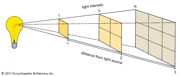

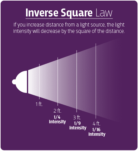

the dissipation aka dropping off in strength is due to the inverse square law ... the dispersion of the wave

Losing intensity with distance because the area over which light spreads has increased is not dissipation.
