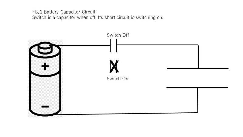

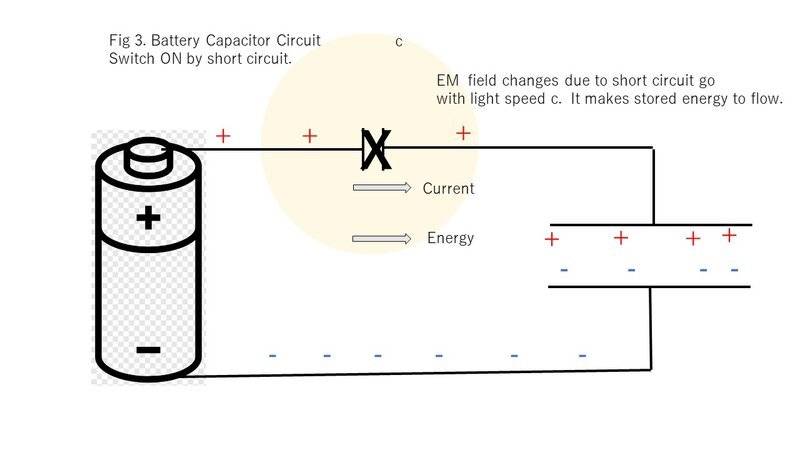

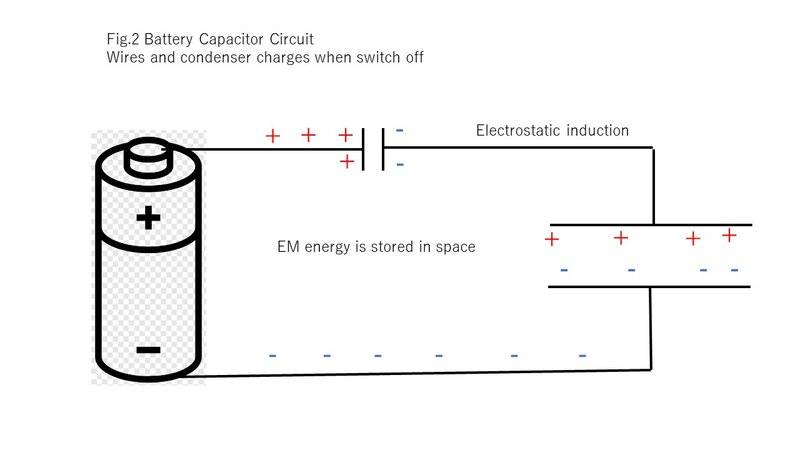

I draw sketches to explain what happens before and after switching on for battery capacitor circuit. I hope it is of your help.
So (additional) charging of condenser or glowing of light bulb in battery-light bulb circuit starts with time delay of ##R/c## after switching-on and grows gradually where R is space distance between switch and condenser/light bulb. Wire arrangements, e.g. straight, winding, zigzag, do not matter.
What point are you trying to make here? When a battery is used as a source of Energy then it is a source of Energy.

I would have liked to describe some details of :
how energy from battery has been stored in space around the circuit before switch-on,
how switch-on triggers flow of that energy, and,
how the effects or signal of switch-on propagate outward to sustain and enlarge the flow of energy.
I hope it would be of OP's interest on mechanism of energy flow.
Yes, with time delay of R/c where R is distance of switch and battery terminal, the battery starts supplying energy to fill out and more energy that once existed but have gone to capacitor/resistor.
