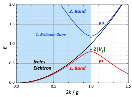

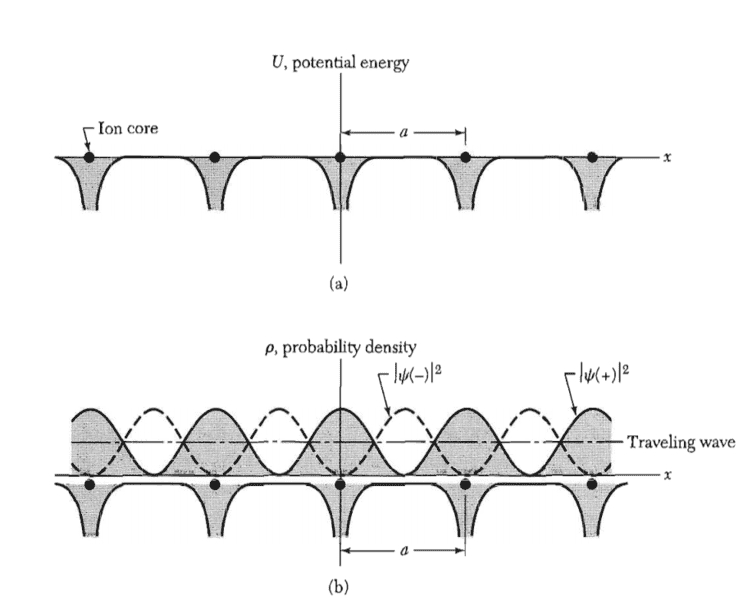

In this picture below you can see the probability density of a symmetric (+) and anti-symmetric (-) standing wave. The energy gap is the difference of the energy of the symmetric wave and the energy of the anti-symmetric wave.

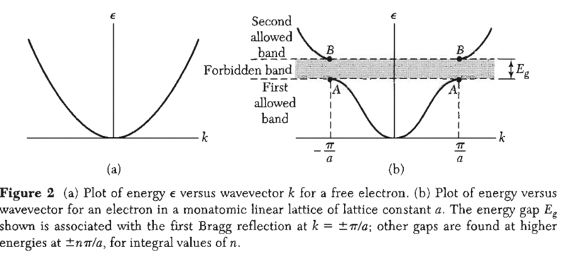

And here you can see the energy gap:
It says that the first energy gap(which we see here between band 1 and band 2) occurs due to the bragg reflection at ##k = \pi/a## and ##k = - \pi/a##. The book from Kittel (Solid Sate Physics) also says:
"When the Bragg reflection condition ##k=\pm \pi/a## is satisfied by the wavevector ##\vec k## a wave traveling to the right is Bragg-reflected to travel to the left, and vica versa."
So the wave with the wave vector ##k=\pi/a## (exactly at a bragg plane, which is the edge of a BZ) will be reflected, which creates a standing wave. Or how can you imagine that?

For this simple 1D case, a wave traveling to the right will reflect to the left if it meets Bragg's condition, which corresponds to ##k=\frac{\pi}{a}##. Since Bragg scattering is an elastic process and we are constrained to 1D, the scattered wave will bounce directly backward with ##k' = -\frac{\pi}{a}##. This can also be worked out mathematically by applying your above stated Bragg equation ##\mathbf k' = \mathbf k + \mathbf G##. It is the superposition of the same electron's initial and scattered wave function that sets up the standing waves. You can generate the standing waves from the initial and final plane wave function ##\exp(\pm i\pi x/a)##. This is how you get the standing waves of form:
##\psi(+) = \exp(i\pi x/a) + \exp(-i\pi x/a) = 2\cos(\pi x/a)##
##\psi(-) = \exp(i\pi x/a) - \exp(-i\pi x/a) = 2i\sin(\pi x/a)##
If you want to visualize this more clearly in your mind in terms of classical standing waves, then the Brillouin zone boundary ##k = \frac{\pi}{a}## corresponds to a wave traveling down a string with wavelength ##\lambda = \frac{2\pi}{k} = 2a## where the lattice spacing ##a## is now just the distance between the endpoints of the string. ##\psi(+)## corresponds to both endpoints free (which sets up a node centered between the endpoints) while ##\psi(-)## corresponds to both endpoints fixed (which sets up nodes at the endpoints). Note that one end fixed and one end free is not allowed because this requires meeting the condition that ##a = \frac{n\lambda}{4}## where n is an odd integer. However, since Bragg's condition requires ##\lambda = \frac{2a}{m}## where m is any positive integer, then combining these conditions gives ##n = \frac{2}{m}##. Hence, no odd integer n exists.

@SpinFlop I see, thank you for the accurate answer. That made me to understand it way more than before. But I still have a few questions below.
1. I know that the energy gap is just the energy difference from the energies of both standing waves ##\psi(+)## and ##\psi(-)## at that exact zone edge:
Which shows this picture very good. The black band corresponds to a free electron. The red one to ##\psi(+)## and the blue one to ##\psi(-)##.
Also due to the periodicity the energy band of purely free electron looks like:
So when we have a 'nearly' free electron there will simply be a energy gap as it shows in the first picture above. The created standing waves merge electrons either on the lattice atoms(##-##) location or inbetween (##+##) them.
But in the end I do not understand yet how the first band (red one) and the second band (blue one) are determined. Like e.g. why is there exactly a standing wave ##\psi(+)## and ##\psi(-)##? So why two standing waves at the same time, which creates the gap and so the first band and second band shown in the first picture I uploaded.
For me is it logically when I send a wave to wall and it gets reflected back there will be a simple standing wave. But why two? How are the two parabola at ##k=0## and ##k=2\pi/a## connected to this topic/each other?
