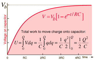

Initially the capacitor is uncharged. You begin by moving a charge from one plate the the other so the work done is very small since potential difference only begins when the charge actually gets to the other plate. As you move more charges the potential difference increases. So the potential difference depends on the net charge Q moved but that charge was moved under a linearly increasing potential difference. Thus the total charge Q was moved under an average potential difference of Vfinal/2 so the net work done is QVfinal/2. Work done = energy stored
Since Q=CV -------> W = E =CV2/2
resistance plays no part in this process.

Why do you refuse the ready made explanations that are in all the textbooks and also the hyperphysics site? The factor of 'a half' is there as a result of integration. If you don't want to do the maths then you are pretty well doomed not to understand this. You need to put in some effort on your own, I think because there is no adequate and simple arm waving reason.
The 'one half' factor is there for the same reason that the Kinetic Energy, SUVAT and Spring Energy formulae have it. It's very basic.

Sophie, thank you for your response. You are correct when you say the energy formula applies to any point on the charging curve - as long as you are referring to the energy of the STATE, not the energy required to attain that state. In other words, we need to make a distinction between the energy content of a charged capacitor, which does not include the energy that must be expended to put that energy there, and the energy required to charge the capacitor, which must include the energy dissipated during the process. I believe the latter is a path-dependent process, since faster charging requires more current, hence more heating due to the finite resistance in the internal conducting path. There is also the matter of leakage current. I haven't tried to calculate its contribution to dissipation during charging. But I think we can say that there are 2 competing processes taking place during charging: adding charge to the cap and losing charge through leakage. At some point, a steady state is attained, in which the rate of adding charge equals the rate of loss through leakage. Thus, even maintaining constant voltage in the fully charged state requires some current to replace the charge lost through leakage.
The formula E = C*V^2 /2 is derived in the online physics tutorials (I no longer own a general physics text.) by calculating the work required to move charge into the cap against the growing electrical potential. When one calculates work against a field this way, dissipation is ignored. The assumption that the field against which work is done is conservative is typically made in physics texts. The textbook transition to systems with dissipation is made when they discuss thermodynamics. In my day, Physics 101 textbooks didn't make this transition explicit (which is a shame since a teachable moment, the historical co-evolution of the science of thermodynamics and the design of heat engines during the industrial revolution, is passed over.)
