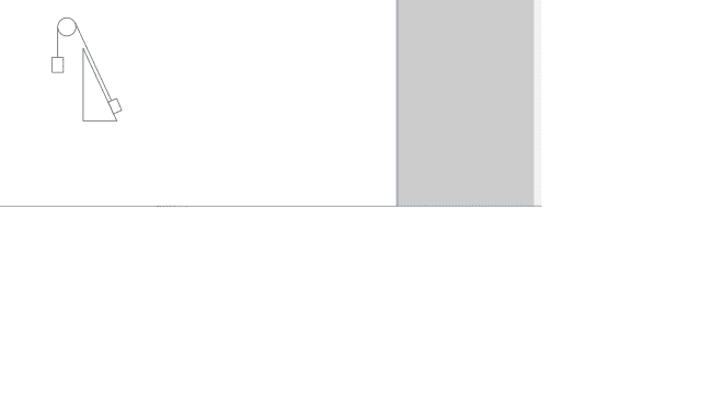

The pulley in the figure has radius R=0.160m and a moment of Inertia I_p = 0.560 kg*m^2. The rope does not slip on the pulley rim. As m_4 (4kg block) drops due to gravity, m_2 (2kg block) is dragged up a ramp inclined at theta = 65 degrees. The coefficient of kinetic friction for the block/ramp is 0.100. Use energy methods to calculate the speed of m_2 after m_4 has dropped 5.00 meters. (Hint the normal force on m_2 is m_2gcos(theta) and change in height is not the same for m_2 and m_4 although they are related to each other).
So first, decrease in PE is equal to increase in KE.
4*5*9.8 = 196 J.
The frictional work done is 1.96*cos65*5 = 9.8cos(65)
The force parrallel is 19.6sin(65)*5 = 98sin(65)
Final KE of the system = 196-9.8cos(65)-98sin(65)
Final KE's of the syem
M_4 = 1/2*4*v^2
M_2 = 1/2*2*v^2
Pulley = 1/2*I*w^2 ==> using w=v/R ==> 10.938v^2
Total KE = 13.938v^2
So:
13.938v^2 = 196-9.8cos(65)-98sin(65)
Which results in a 2.72 m/s
Should I have used the coefficient of friction instead of doing what I did? :O
Is there anything wrong with this reasoning?
Where's the figure?
Likes RJLiberator
Here it is, sorry.

You'll have an easier time keeping things straight if you viewed it as ##\Delta E = \Delta KE + \Delta PE = Work_{friction}##. (Realizing that the work done by friction is negative, of course.)
Likes RJLiberator
Also, when they state that the change in y is not the same for both of them, I assume this means that M_4 = 5 while m_2 you must use trigonometry as I did with 5cos(65) and 5sin(65). Correct?
Yes. The change in height is relevant when finding the change in PE. The 5sin(65) is the change in height of m_2.
Likes RJLiberator
Hm. If I do that I insert the following:
Change in KE = final - initial
Final I found to be 13.938v_f^2
Initially the system is at rest so KEi = 0.
Change in PE
Final = 4*-5*9.8 =-196J
Force due to friction is 1.96*cos(65)*5 = 4.1416
This nets me the answer of 3.78 = v_f :O
I feel like I am doing something wrong with the change in PE ?
RJLiberator said:
Change in PE
That's the change in PE of the m_4 mass. What about the other mass?
Likes RJLiberator
It would then be 2*9.81*5sin65 = 17.76
So -196+17.76 = -178.24
Plugging this back into the equation: 14*x^2-178.24=4.1416
I get x = 3.61
Redo that bit of arithmetic.
Likes RJLiberator
Oi. You are absolutely right, I had foolishly forgotten about the 5 in 5sin(65).
So 2*9.8*5sin(65) = 88.82.
So -196+88.82 = -107.18
13.938*x^2-107.18=4.1416
= 2.82 m/s which is similar to my original answer of 2.72 :O
Hm, I'm looking at both methods here and wondering why I am getting the difference of .1.
Admittedly, the way you suggested to do it was much more organized and to the point. It just made sense.
I would assume that this method would produce the more exact result, being 2.82.
