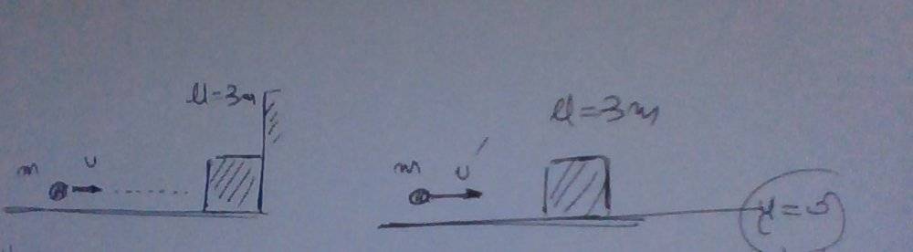

1. The problem statement, all variables and the known data
A bullet (mass m) is shot with an initial velocity (V) towards an object with mass M=3m as shown in the picture. The energy needed to penetrate the object is 30J.
The same bullet is shot with a velocity (v) heading to an identical object with the one mentioned above. If the coefficient of friction is μ=0 then what is the necessary energy so that the bullet penetrates the object.
.I tried to use energy theorems for the first case and I found some equations involving the speed of bullet. The same and for the 2nd case. The problem is that I can not find a way to connect the equations of the 2 cases. Please help me.

In the first case, where the object is up against the wall, all the energy goes into penetrating the object. But in the second case that cannot happen since the object is free to move and thus some of the energy of the bullet must be used for the overall KE after the collision. Hint: What's conserved in any collision?

In the second case the bullet flies at speed v. At what speed will the combined bullet and block move? How much energy is needed for that?
I'm not sure about the wording of this question and the significance of v vs V in respect of velocity. The question appears to be asking for a comparision of energy loss in a perfectly inelastic collision given a) 3m mass can't move b) 3m mass can move. We can't do such a comparision unless the bullet is fired with the same velocity in a) and b).
$$ ΔE = ½μΔv^2 $$
No, the question is ok. The energy to penetrate is the same in both cases. The question is asking how much extra energy (hence extra velocity) the bullet needs when the block is not restrained.
Ok - got it. Thanks for the clarification. Above equation should assist if the OP is familiar with it (probably not!)
