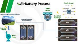

Please show how you would set this up schematically in terms of piping and turbine. Why do you feel you need to put a number on this?
I'm sorry, I don't think I understand what you mean by schematically. Could you give an example? The question is interesting to me and hopefully to others. Thanks for the discussion.
I found this diagram of an airbattery. This looks like a good example.
