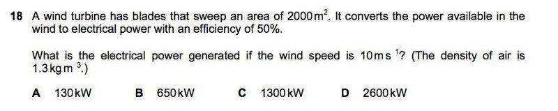

yan_plusheartz
Relevant formula
: p(out) / p (in) x 100 percent = efficiency
My question
My approach
But the right answer is 650kW
You use P = F x v but you write ##\rho## x Area x v3. Is that the same ?
Yeah I understand that it is not exactly the same. But my problem is , I don't have the value for F and v . And the only formula I know for power is force x velocity. So I did it by using the values given to derive a unit which is the same as power. But I can't seem to get the right answer. and I'm not sure whether my approach is correct or not. Can you teach me the correct method?
anyhow, thank you for taking your time to try to solve my question:)
Yes I can. You know that power is energy / time ?
How much energy does the wind bring in /time ?
If that case, the wind energy is 1/2 m (10)*2 am I right? Problem is , I don't have the value of mass and time :(
That is correct. And they give you the area and the wind speed.
