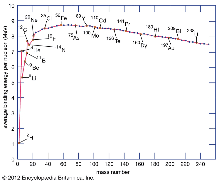

Suppose a craft derived its energy from fusion— converting Hydrogen into Iron…
If it started with a kilo of Hydrogen, how much mass of Iron would it have at the end and how much energy would be extracted?
The number of nucleons won't change in the process. You can look how many your target iron isotope has, that's how many hydrogen atoms you need per iron atom (if you start with normal hydrogen, it's less with deuterium or tritium). You can look up the masses of hydrogen and iron and compare.

Not to rain on your parade, but while this fusion engine would not facially violate any laws of physics, as a practical matter, it is basically an engineering impossibility.
In the real world, iron is created through nuclear fusion processes that start with hydrogen in a multiple step process interrupted by supernovas at intermediate steps. Early stars converted hydrogen to intermediate sized elements, went supernova, and then had some of those intermediate sized elements that the supernova spits out end up in a new star where they are fused in the second star in the fusion sequence, and so on, until eventually Nth generation star in the sequence fuses medium sized elements into iron.
If the craft likewise used a multiple step process, the energy generated in the intermediate steps in a way that attempted to hold onto the fusion products produced would blow the craft apart before it could get to the next steps.
If the craft tried to do it in one step, the problem is that it is virtually impossible to get dozens of hydrogen atoms to all fuse and organize themselves into an iron nucleus in the same place at the same time. It is hard enough to get two component atoms in once place at the same time in the right conditions to fuse.

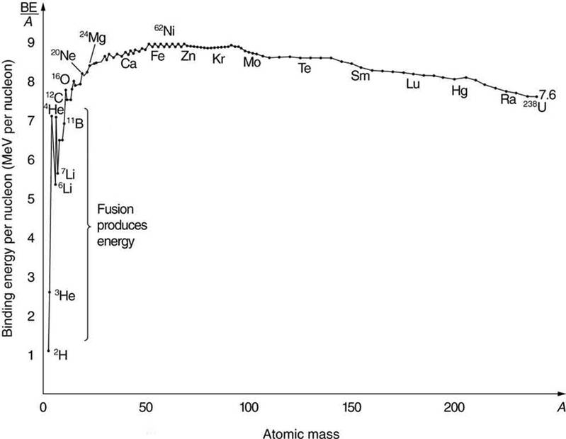

This said, most of the energy gains from nuclear fusion happen at the beginning of the nuclear fusion chain ending with iron, and not at the end of it, as illustrated by this chart:
The initial leap from deuterium to helium-4 produces about 80% of the energy per nucleon return of the entire chain from deuterium to iron, and is eminently possible from an engineering perspective.
Proton-proton fusion has such a low cross section that we still haven't measured it (in the lab, we see it in the Sun). Fusion reactors on Earth use deuterium and tritium, reducing the difference to ~3.5 MeV per nucleon.
I don't disagree which is why I referenced starting with deuterium rather than hydrogen-1.

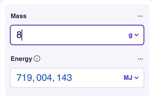

Getting a bit further into answering the original question.
Nuclear fusion generates 580,000,000 MJ of energy from a kilogram of heavy hydrogen (i.e. Hydrogen-2 and Hydrogen-3) by fusing it into Helium. In contrast, hydrogen fuel cell produces 142 MJ/kg. Natural gas (i.e. basically methane) produces 54 MJ/kg and gasoline produces 46 MJ/kg.
MJ = megajoule and kg = kilogram and 1 Joule [J] = 1 Watt-second [Ws] = 1 V A s (volt-ampere-second)= 1 N m (Newton meter) = 1 kg m2s−2 (kilogram-meter squared per second squared).
In theory, if it went from heavy hydrogen straight to iron, it would generate 725,000,000 MJ of energy from a kilogram of heavy hydrogen (i.e. 7.25 * 108 MJ).
The energy that would be created by converting 1 kg of matter directly to pure energy (via the E=mc2 conversion) would be 89,875,517,878.0128 MJ (i.e. roughly 9 * 1010).
So, the energy produced in the fusion reaction would be equivalent to a mass almost exactly 8 grams converted to pure energy.
The mass of the end product of converting 1 kg of heavy hydrogen to iron in nuclear fusion would be 992 grams of iron.
These calculations have a roughly 1% uncertainty.

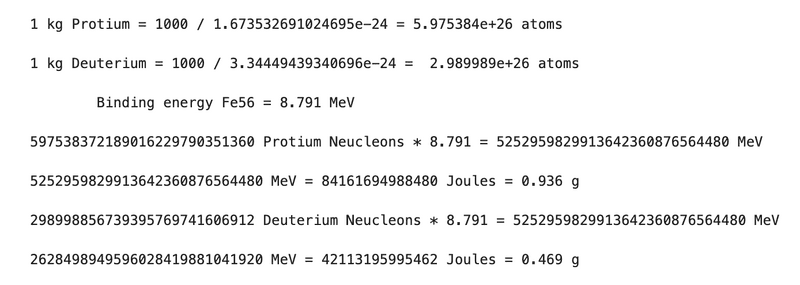

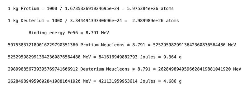

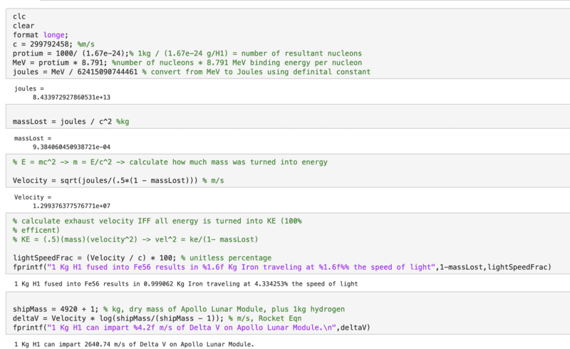

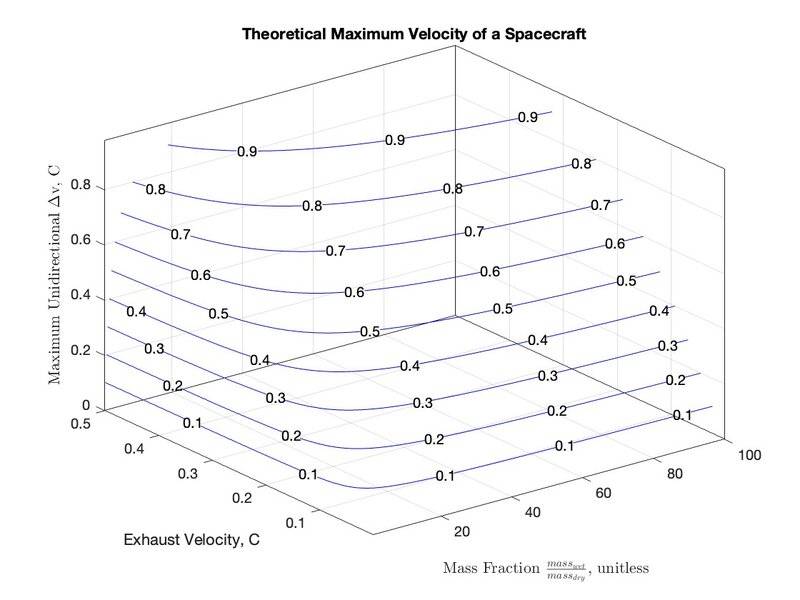

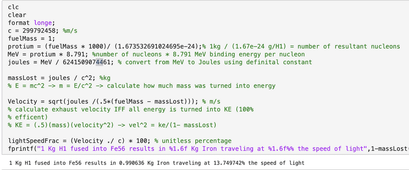

I stumbled upon this thread and was curious, so I took a crack at the math. I'm not a physicist so please point out if I've made any errors.
The above makes the assumptions that all gamma rays and intermediary reactions have their energy entirely absorbed in the reaction, and that the iron exhaust is at absolute zero relative to itself. Others have already commented on the infeasibility of such a design. Even so, if engines of such a design were incorporated into the Apollo Lunar lander, the kilogram of hydrogen would barely be sufficient to accelerate it to the moon's relatively low escape velocity.
Welcome to PF.

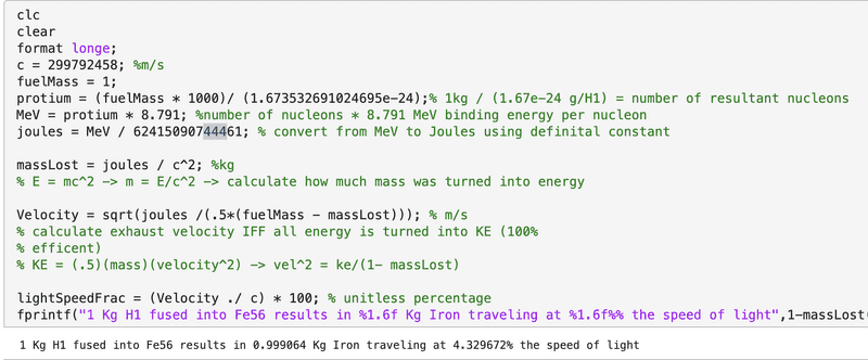

Please repost this using code tags to make it easier to read your code. Enclose your code in these tags: [ code ] ..... [ /code ] (but without the spaces). Thank you.
berkeman said:
Welcome to PF.
...That's the output of my calculator. I didn't feel the need to write up code for this, but if you'd like some:
Code:
#include <stdio.h>
#include <cmath>
#include <iostream>
using namespace std;
int main() {
float c = 299792458;
float protium = 1000/ (1.67 * pow(10,-24));
float MeV = protium * 8.791;
float joules = MeV / 62415090744461;
float massLost = joules / (c * c);
float vel = sqrt(joules / (.5 * (1 - massLost)));
float lsf = (vel / c) * 100;
cout << "1kg H1 into Fe56 results in "<< 1 - massLost << " kg Fe traveling at "<< lsf<< "% the speed of light."<<endl;

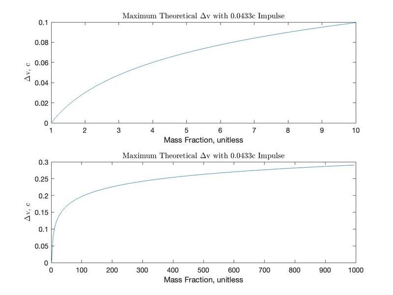

Because I was curious, I ran the calculations a few more times with different fuel payloads. This is not my area of expertise; but I imagine as the velocity increases relativity becomes an important factor, so true values are lower than my calculations. I was surprised just how much energy it takes to reach appreciable fractions the speed of light, so I thought I'd share.
1 Kg H1 can impart 2640.74 m/s of Delta V on 4920 kg spacecraft:
0.000009% the speed of light
49201 Kg H1 can impart 31157924.82 m/s of Delta V on 4920 kg spacecraft:
0.103932% the speed of light
98401 Kg H1 can impart 39559931.13 m/s of Delta V on 4920 kg spacecraft:
0.131958% the speed of light
147601 Kg H1 can impart 44620503.74 m/s of Delta V on 4920 kg spacecraft:
0.148838% the speed of light
196801 Kg H1 can impart 48253342.61 m/s of Delta V on 4920 kg spacecraft:
0.160956% the speed of light
246001 Kg H1 can impart 51089265.26 m/s of Delta V on 4920 kg spacecraft:
0.170415% the speed of light
295201 Kg H1 can impart 53415767.20 m/s of Delta V on 4920 kg spacecraft:
0.178176% the speed of light
344401 Kg H1 can impart 55388292.57 m/s of Delta V on 4920 kg spacecraft:
0.184755% the speed of light
393601 Kg H1 can impart 57100466.85 m/s of Delta V on 4920 kg spacecraft:
0.190467% the speed of light
442801 Kg H1 can impart 58613071.88 m/s of Delta V on 4920 kg spacecraft:
0.195512% the speed of light
492000 Kg H1 can impart 59967785.79 m/s of Delta V on 4920 kg spacecraft:
0.200031% the speed of light
I used the dry mass of the Apollo LM, which barely held 2 crew for less than 3 days, and made no correction for the mass of the hypothetically perfectly efficient protium engines nor the infrastructure to store the fuel.
Fuel mass of 100x the dry mass *barely* reaches 0.2% C. At 1000x, 0.299%. Really drives home how ridiculously hard interstellar travel is.
One needs to include the mass of the tanks that are used to confine the liquid hydrogen.

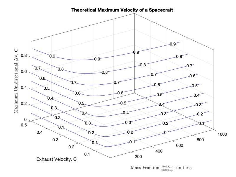

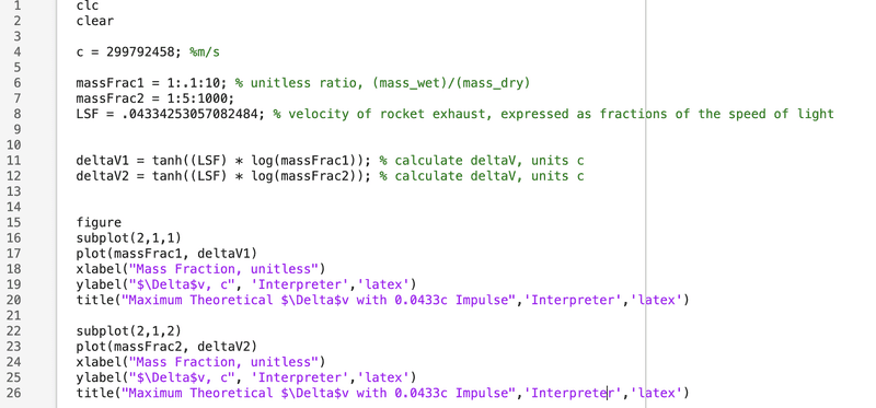

The rocket equation is what governs the maximum change in velocity of a self-propelled spacecraft.
Δv is dependent upon the velocity of the engine's exhaust, and the ratio of the wet mass (ship + fuel) to the dry mass (ship with no fuel). The numbers themselves are irrelevant, what matters is how much of the ship's mass is fuel.

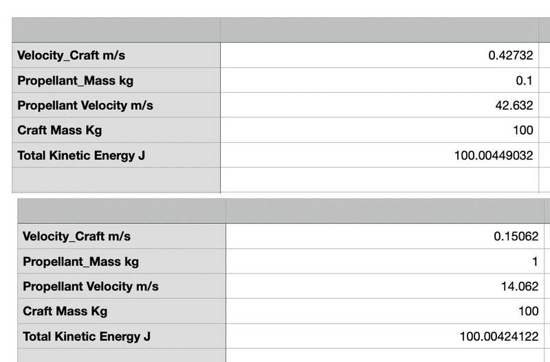

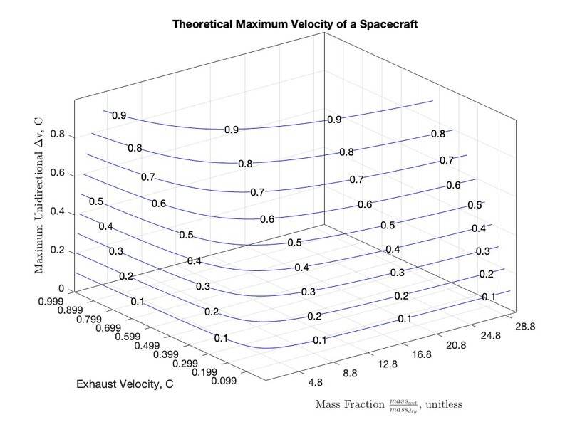

While true in an ideal case, the value assigned to the 'numbers' are relevant, and each must represent a physically reality. The dry mass of the spacecraft excluding the propellant must include not only the payload, but the propellant storage systems and mass of the power conversion system. The Isp must be realistic (obtainable). The devil is in the details.
One used an exhaust velocity of ~1.3E7 m/s or ~0.04336 c. That does not seem realistic. The mass of the propulsion system is a function of Isp. Accelerating ~ 1kg of Fe will require quite a distance, and it would be impractical to convert H to Fe, only to accelerate the Fe. One might wish to calculate the distance required to accelerate 1 kg to 1.3 E7 m/s at g (=9.81 m/s2), 10g, 100g, . . . . , and determine the forces on whatever system is used to accelerate the mass. One may wish to consider relativistic effects.
I'm quite familiar with the 'rocket' equation.
https://www1.grc.nasa.gov/beginners-guide-to-aeronautics/ideal-rocket-equation/
In a fusion based system, one will likely discover that mass(dry) >> mass(propellant), and so one's ##\frac{m_0}{m_f}## ~ 1, or the ln(~1) ~ very small.
I encourage you to run the numbers yourself. I agree, they feel wrong: that's why I posted the equations, steps, and assumption I took.
Newton observed that every action has an equal and opposite reaction1: as a result, in order to accelerate under your own power, you must leave some mass behind. As I'm sure you recall, the natural logarithm of 1 is 0; from this fact and your familiarity with the rocket equation, I'm confident you can understand why the mass of the fuel must be substantial relative the to mass of the craft (masswet >> massdry), for any high-velocity design.
My calculations describe the upper bound of a purely fusion-based propulsion system, not an implementable design.

There's a LOT of simplifications and unrealistic assumptions made in this thread. A significant number of the more impossible assumptions were made by me. I took a little time to make some graphs to (hopefully) make the topic a little clearer.
These graphs shows the maximum possible change in velocity for a self-propelled spacecraft at revalistic velocities. Reserving fuel to slow down requires calculating in terms of rapidity, which I felt would make the answer too technical for this context. The take away is that these graphs are valid if and only if the acceleration is unidirectional, using the following formula:
$$ \Delta v = c ~tanh~\frac {Velocity_{exhaust}}{c} ~ln ~\frac {mass_{wet}}{mass_{dry}}$$
Recall that c = 299,792,458 m/s, and ##mass_{dry}## is everything that is not the fuel. Engines, life support, shielding, fuel storage infrastructure, etc. Therefore, ##mass_{wet} = mass_{dry} + mass_{fuel}##.
This first graph shows what I think is the most "realistic" data. Rocket exhaust between 0 and 0.5 C, with a mass fraction between 0 and 100. Notice the asymptotic behavior of the graph in two dimensions:
##\Delta##v depends on the natural logarithm of the mass fraction (##ln \frac{mass_{wet}}{mass_{dry}}##) so high velocity space travel requires a mass fraction of no less than ##e##, or your craft can never accelerate up to the exhaust velocity.
##\Delta##v also is a function of hyperbolic tangent, which conveniently handles the pesky can't-travel-faster-than-light issues. As your mass fraction approaches infinity and your exhaust approaches c, your maximum ##\Delta##v approaches c as well. This helps to underline why the graph is only valid for unidirectional acceleration: it's assumptions make it impossible to carry over c ##\Delta##v.
Alright, but what if you really wanna go fast. Increasing the mass fraction, as show in the figure above, allows for much higher velocity travel with lower exhaust velocity. The downside is very little usable payload:
$$ \frac {mass_{wet}}{mass_{dry}} = \frac {mass_{dry} + mass_{fuel}}{mass_{dry}}$$
At a mass fraction of 1000, every 1kg of ship needs 999kg of fuel, and again: that 1kg must include the mass of whatever stores the 999kg of fuel, as well as every other component of the ship.
Given the impracticality of an ever-increasing mass fraction, what about increasing the exhaust velocity? The figure above shows the relation if the engines' exhaust velocity can be scaled up to .999c. Increasing impulse is substantially more effective than increasing the mass fraction. This implies that efforts made towards interstellar travel should focus more on increases in engine impulse than increases in fuel capacity.
This post has strayed a little far from the original question asked, so to bring it back to the relevant context, the purely fusion powered engine discussed has an impulse of ~ 0.14c If it is 100% efficient at turning protium into iron. Hopefully the cacophony of other posters balking at that demonstrates the folly of assuming that such an engine could be constructed.
If you care less about how possible it is to build, the figure below shows the maximum unidirectional ##\Delta##v of a spacecraft powered by 100% efficient H1 to Fe56 fusion engines.
Again, these are theoretical values, and make no claims on the practicality or possibility of building such a spacecraft.
If you would like to learn about the various elements that go into designing a spacecraft, I strongly recommend The New SMAD. The book is a little pricey, but it's an amazing resource used throughout the industry. The section on spacecraft and payload design is about 430 pages long and walks you through the various elements and considerations.
If you'd like to learn about more realistic orbital maneuvers, the way current spacecraft move in space, I've found both Orbital Mechanics for Engineering Students and Interplanetary Astrodynamics to be great books. These are textbooks used to teach the material to undergraduate students and do a fantastic job covering the basics in an entertaining and (relatively) easy to follow manner. Getting where you're trying to go in space is substantially more complicated than pointing where you want to go and hitting the gas. That said, they assume a strong background in physics and calculus, as well as at least a moderate ability in programming.
What program did you use for these plots?
(Sorry, off topic...)
Do the plots specifically assume hydrogen to iron fusion, or do they more generally show the relationship between mass fraction and exhaust velocity, regardless of energy source?
This is all it took to calculate and plot the 2 graphs showing the H1 to Fe56 velocity.
I've edited the post to add information clarifying this. Most of the graphs show the relationship regardless of energy source. The 2 graphs I just added show specifically the craft powered by H1 to Fe56 perfectly efficient fusion engines.
  • #31
Does that mean each 1kg of Hydrogen to Iron fusion generates enough energy essentially to accelerate 992 grams of Iron "out the back" at 0.043c (lets say on a static test stand)?
  • #32
This is not my area of expertise. If I have made no errors in the math, it means that each 1 kg of H1 becomes 999 g of Fe56 and releases 84.33 Terajoules of energy.
IF 100% of that released energy is kinetic energy, the iron would be traveling at 0.043c. Keep in mind that heat is kinetic energy, and temperature is just a convenient way to say "average kinetic energy of the atoms in a material". This means that in order to reach 0.043c as exhaust, the iron atoms must be in a reference frame where they are completely stationary to each other, i.e. at absolute zero. If that sounds ridiculous, it is.
AND this ignores that in fusion, some energy is released as gamma radiation. This hypothetical engine takes all of that radiation and somehow uses it to accelerate and cool the reaction. It's beyond ridiculous to think it could ever be built.
But it is fun to think about.

Earlier in the thread someone mentioned 8 grams is turned to energy.
Yes, I read through that:
Thank you. I had fat fingered an extra '4' in the conversion from MeV to Joules. Our numbers still disagree by a lot; I'm double checking all my other values now to see if I can find another error. In the meantime, your fusion rocket just jumped from .0433c to .1375c now that I'm converting the energy properly.
  • #41
I had fat fingered an extra '4' into the conversion from MeV to J in my original calculations, as highlighted in the screenshot of my calculations below:
Correcting that mistake yields the following:
Since I used Joules to calculate both mass lost and the velocity, the conversion error had a profound impact on the final numbers I generated. As I stated, nuclear physics isn't my forte: I've been unable to find another source of error in my math, however I have no formal education in the subject and am not confident none exist. I would appreciate anyone deeply knowledgeable in the subject reviewing the math and identifying any further errors made.

Suppose we have 2 skaters initially at rest, one pushes the other, so they go in opposite directions.
One skater is the craft (100kg), the other skater is the propellant (either 1kg or 0.1kg)
After the push, in both cases the total combined kinetic energy of the craft and propellant is the same (100J).
Does the craft move faster if the propellant is 1kg or 0.1kg?
I found that the craft picks up more speed if the propellant is 0.1kg.
Craft velocity is 0.15m/s with the 1kg propellant, and craft velocity is 0.42m/s with the 0.1kg propllant
a=v_craft_m/s
b=propellant_mass_kg
c=propellant_velocity_m/s
d=craft_mass_kg
a=(bc)/d
e=total_kinetic energy_J
e=((1/2)*b*c^2)+((1/2)*d*a^2)
