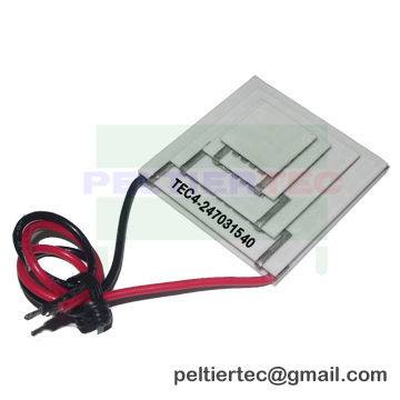

Look into Peltier modules and the Seebeck effect. A single small module can produce about 1.7W with a small temperature difference. See a demo.
Temperature differences can be achieved by solar collector or even by heating water (fire!) on cloudy days.

I have a question about thermoelectrics which I've been wondering about.
There seem to be stacked modules when it comes to cooling applications but is it possible to stack modules on top of each other to increase efficiency when generating electricity?
For cooling, modules are stacked because each one produces a limited amount of temperature difference for a given working current. By stacking, these temperature differences can be summed.
For power generation you're applying a temperature difference and obtaining a potential difference and current. You want to maximize the temperature difference (or at least operate the module at its optimum temperature difference). Stacking doesn't help with this, in fact it would make getting each module to its optimum ΔT more difficult.
