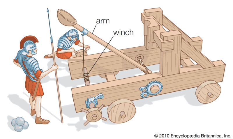

TL;DR Summary: In a classic catapult the arm usually meets a cross brace that stops it and helps define the exit angle. This seems a bit wasteful.
I have been thinking about making a small catapult for my sons class.
When looking at trebuchets, optimization can be done to maximize the energy transfer to the projectile, eg. matching counterweight to projectile, allowing the frame to move on wheels, and other things.
I haven't really found anything similar for a simple catapult.
Any ideas?

What ideas have you been thinking of so far? You say you haven't found anything, but have you tried brainstorming some with your son? I can think of at least one mechanism that would help the efficiency a fair amount (initial guess is 10-20%)... :smile:

A free swinging catapult with a low inertia arm is probably my first approach. The challenge is then to optimize for power input in relation to the mass of the projectile.
My goal is to have a 20g projectile launch around 15m. So I need input energy in the order of 1.4J. Assuming low efficiency, <50%, I need around 3J input.

BTW, my idea to increase the efficiency was to recover some of the energy that you mention is lost when the rapidly-moving arm hits the top stop. I agree that that energy is lost, so why not try to recover as much of that energy and use it to lower the amount of energy needed to input to the arm for the next shot... Can you think of a way to recover that energy at the end and then be able to use it to make it less effort to load the next shot?
Also, my definition of "efficiency" here may be different from what you want. I'm thinking "energy per shot for multiple shots in a row", and you may be thinking "get the most distance out of each shot with an initial investment of Potential Energy (PE)".
Can you be a bit more specific about the design? What is the energy storage… something elastic I assume, either twisted or stretched.
If it can be modelled as a spring, ##\Delta F=k\Delta x##, then the stretch varies from ##x_0## to ##x_1## and the energy stored is ##\frac 12k(x_1^2-x_0^2)##.
You may think that this wastes ##\frac 12k(x_0^2)##, but as @berkeman notes, that energy is a constant, never used, never lost. Attempting to use it takes up available range of x, limiting ##x_1##. (In the same way, a bow is strung such that there is considerable tension even before the string is drawn back. Note that a bow cannot be modelled as a simple spring, though, because the angle between the string and arrow changes during release.)
So the only wasted energy is the KE left in the arm.
