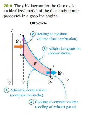

Below is the diagram that I came across in the Physics textbook by Sears & Zemansky. Isn't the IC engine going through a cyclic process according to this diagram as it returns to its original pressure-volume state at point a?
Let's test your understanding of a some thermodynamics fundamentals.
True of false:
1. In a thermodynamic cycle, the thermodynamic state of the working fluid is the same at the beginning and end of thermodynamic cycle.
2. In a thermodynamic cycle, the internal energy of the working fluid is the same at the beginning and end of the cycle.
3. At point b in the diagram, the thermodynamic state of the gas mixture before step bc is the same as the thermodynamic state of the gas mixture after step ab.
4. In step bc of the Otto cycle, heat ##Q_H## is actually transferred across the boundary of the cylinder from the engine block to the gas mixture.
5. In thermodynamics, the heat Q in the first law equation represents both heat in transit across the boundary of the system and heat generated by chemical reaction within the system.

Yes, for the initial Isochoric temperature rise step, both Q and W are zero. So we have for that step:
$$\Delta U=Q-W=0$$with, per unit mass, $$\Delta U=\Delta U_R+C_v\Delta T=0$$where ##\Delta U_R## is the change in internal energy per unit mass due to chemical reaction and Cv is the heat capacity per unit mass of products. So the temperature rise in this step is $$\Delta T=\frac{(-\Delta U_R)}{C_v}$$which is positive for an exothermic reaction.

@Chestermiller :
Nobody is saying you are technically wrong, but it's not only what is found on the Internet, it's also written in every book and taught at every University in every thermodynamics class:
https://en.wikipedia.org/wiki/Internal_combustion_engine said:
An internal combustion engine (ICE) is a heat engine in which the combustion of a fuel occurs with an oxidizer (usually air) in a combustion chamber that is an integral part of the working fluid flow circuit.
The Otto, Diesel, or Brayton cycles don't specify that the engine must have an internal combustion (heck, it doesn't even assume a combustion). In theory, you can build an engine based on these cycles with an external combustion.
Imagine we build 3 imaginary engines, build on the same cycle, with the same thermodynamics specs:
  1. One works with an external combustion, transfers heat through the cylinder;
  2. One has a combustible mixture injected into the combustion chamber that stays near the walls and heats up air in the middle. There is an imaginary boundary between the combustible mixture and the air because the combustible mixture never mixes with the air;
  3. One has the same combustible mixture mixed in with the air (pure internal combustion as we know it).
What you are saying is that engines 1 and 2 are heat engines and the third one isn't. But I never heard of an "internal energy" engine. And the end results are the same for every engine, impossible to differentiate thermodynamically speaking. So if engine 3 is not a heat engine, what is it? And I would appreciate a source. (Let me also recall you that we are in the Introductory Physics Homework Help section)

vcsharp2003 said:
Heat is not flowing into or out of the cylinder i.e. it's an adiabatic process, but won't heat energy be generated as a result of the drop of fuel burning?
Of course. You are using the word heat in a common sense way but some answers above are using specific technical terms that use different words like bookeeping terms depending on what is happening.
Likes Lnewqban and vcsharp2003
bob012345 said:
Call it merely an internal energy change but the reaction products contain a great amount of energy in the form of heat and do a lot of work. It amounts to a release of internal chemical energy as heat. And most of it does pass as heat out of the cylinder into the engine block to dissipate anyway.
Could it be that the ignited fuel becomes a heat reservoir as soon as it's ignited, which then causes the temperature of entire volume of gases in the cylinder to rise? So, effectively heat flows from ignited fuel i.e. heat reservoir to surrounding gases within the same cylinder.
vcsharp2003 said:
1. True
2. Not sure, but I do know that state variables P,V,T return to their original values
So are you saying that the initial state before combustion is the same as the final state after combustion or not? Are you aware that internal energy of a gas mixture depends not only on P, V, and T, but also the chemical composition of the mixture, and if that changes due to chemical reaction, U changes?
vcsharp2003 said:
3. True (P,V values at b are same whether we consider ab or bc)
Wrong. What you are saying is that there is no difference between a mixture of gasoline and air before combustion and the corresponding mixture of combustion products after combustion. The internal energies, entropies, and enthalpies of these mixtures, even at the same P and V are different.
vcsharp2003 said:
4. False
Correct.
vcsharp2003 said:
5. True ( Q is heat added which is the sum of all heat energies involved including inflow, outflow)
Incorrect. In thermodynamics, the heat Q in the first law equation represents only heat in transit across the boundary of the system. Energy released by chemical reaction is not included in Q.
Fundamentals of Engineering Thermodynamics, Moran et al: "The symbol Q denotes an amount of energy transferred across the boundary of a system in a heat interaction with the system's surroundings."
jack action said:
@Chestermiller :
I would never teach it that way, especially if the student is supposed to be learning the subject correctly.
Maybe I went too far when I said the the IC engine is not a heat engine. What I meant was that it is not a standard heat engine operating in a closed cycle. Moran et al, Fundamental of Engineering Thermodynamics discuss "standard-air" Otto and diesel cycles, in which the gas is inert, and in which heat actually is transferred to the working fluid in the Isochoric temperature rise step. However, this differs from an IC engine "cycle" where no heat exchange with the surroundings occurs in this step.
Even though the end results are the same, I disagree with the philosophy of dumbing down course material to make it more palatable to the novice student, even if it is "a little incorrect fundamentally (with the intention of later correcting it as the student covers more advanced material). This always causes confusion for the student (as, for example, in the situation where heat capacity is defined in terms of heat rather than in terms of internal energy and enthalpy).
Likes jack action
It does not release internal chemical energy as heat. The release of internal chemical energy goes directly into raising the temperature with no intermediate amount of heat leaving or entering the gas. And I'm talking only about the combustion step in the process. Of course, later in the cycle, actual heat does pass out of the cylinder, in transit across the cylinder boundary.
Likes bob012345
  • #31
Your system is the entirety of the gas, and no heat flows into or out of this system from the surroundings (the engine block) during the combustion step in the process.
