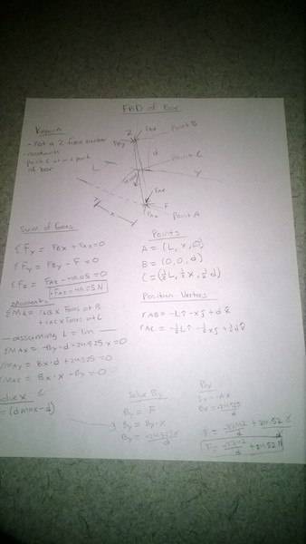

Ends A and B of the 5-kg rigid bar are attached by lightweight collars that may slide over the smooth fixed rods shown in the figure.
The center of mass of the bar is at its midpoint. The length of the bar is 1.5 m. Determine the horizontal force F applied to
collar A that will result in static equilibrium as a function of the distance, d (0.5 ≤ d ≤ 1.5 cm).
sum of forces and moments are zero
Point A only has resisting forces in i and k directions
Point B only has resisting forces in i and j directions

I looked at the rest of the problem (That I didn't already post):
2. Derive an expression for the horizontal force F applied to the collar as a function of distance, d and length, L that will result in static equilibrium. Include all free body diagrams and equations of equilibrium.
3. Plot force F vs distance, d for (0 < d < 1.5 m) for three cases: L = 0.5 m, L=0.75 m, and L = 1 m. How do force, d, and length, L, relate to one another? Explain your graph/comment on the relationship between these three values (F, l, d).
I decided that my second assumption was correct, or at least let's me finish the problem so I at least have something to turn into my professor. Here is a go at the second problem:
My figure might be hard to read, but I let the "1m" dimension on the original figure be "L" and i left d as is (k directional distance from point B to zero. and then I added in a new variable "x" for the last length.
I also show the forces on the bar: By, Bx, Ax, Az, F, and the 49.05N force due to gravity. A new point was created to represent where the force due to gravity is.
Then I summed up all the forces Fx, Fy, and Fz. Here I found that Faz = 49.05N
I then defined points A, B, and C using L, d, and x. Used these points to make position vectors rAB and rAC.
Using the position vectors and force vectors, I used a cross product to find out the sum of the moment at point A. I assumed L = 1m, organized the moments by components x, y, and z.
Since By = F, I decided to solve for By, but then found that I needed to find x in terms of d.
I found that x = (dmax - d) and with L = 1, dmax = 1.118. Thus x = (1.118 - d)

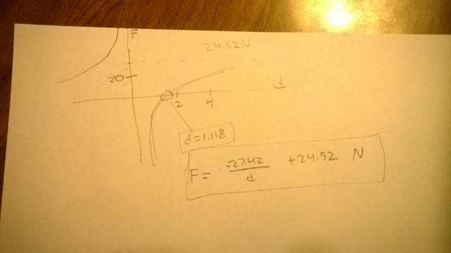

I substituted in my new definition of x and found that F = -27.42/d + 24.52 N (for L = 1m)
Here is what the graph looks like (had to draw it since Wolfram wants money now)
What this graph seems to say is that when d reaches its maximum, F is zero. I suppose that makes sense.
What i am a little worried about is that When d is smaller than maximum, F is in the opposite direction I show it to be. F also goes to infinity as d reaches zero, which also makes sense. As far as the magnitude of F goes for any point d, I am not sure if it seems logical.
Does this look right to anyone? Did i make a terrible mistake assuming x = (dmax - d)? Any feedback would be great
