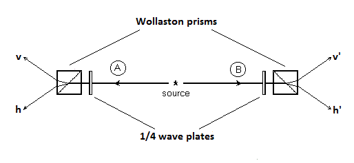

Secondly, could you have a look at this ideal EPR set up.
Now let's say the photon going to the left towards Alice (A) has left hand circular polarisation and is transformed by the quarter wave plate into a vertical linearly polarised photon. This photon then passes through the Wollaston prism and follows the v path to a detector registering a positive detection. The other entangled photon of the pair going towards Bob (B) has right handed circular polarisation (presumably). On reaching the quarter wave plate it is transformed into horizontal linearly polarised light and goes to the h' detector of Bob. Now let's say Alices primary detector is v and Bob's primary detector is v' then the results of a ten photon pair series might look like this:
v = 1001011100
v' = 0110100011
So we have a 100% correlation here. Every "1" received by Alice corresponds to a "0" received by Bob and vice versa.
Now if we happen to be recording the horizontal channels at the same time, the results of those two channels should like this:
h = 0110100011
h' = 1001011100
I am assuming that is what you would record because every time we detect a photon on the v channel we should get no detection on the h channel and vice versa. We either get a positive detection at v or at h but not both simultaneously.
Now the problem is this. If Alice make detections on her v channel and Bob makes detections on his h' channel, then the results look like this:
v = 1001011100
h' = 1001011100
but this is not what QM predicts. If Alice and Bob have different orientations for their detectors (Alice is measuring vertical polarisation and Bob is measuring horizontal polarisation) then there should be only be a random correlation and not 100% 1 for 1 agreement. What is it that I am misunderstanding here? Is the experimental setup wrong? Are my assumptions wrong? Please correct my mistakes if you can and describe a working model.

Your first remark in the quoted text is correct. But the general assumption is that Alice and Bob measure the same observable, which conflicts with the assumption you made.

Could you elaborate on my mistaken assumptions (I am sure there some, but not exactly sure where).
For example if the following observations are made on the v channels:
v = 1001011100
v' = 0110100011
can you give a similar example of what should be recorded on the h channels?
Also, it might well be that the experiment has to be modified. For example do I need to place regular polarisers after the 1/4 wave plates so that if Bob has his polariser orientated vertically he can only detect vertically polarised photons?
I think I understand that if an observation is made of say the vertical polarisation of the a photon, then the horizontal component is indeterminate (correct word?). In other words we can not have certain knowledge of both complementary observables of photon by measuring one component is entangled photon and the other component in its entangled partner. Correct?

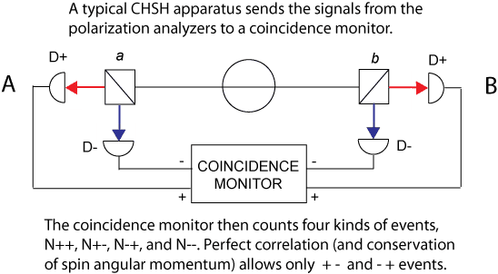

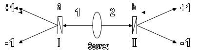

The set up in the earlier post possibly does not work because it seems to set out to acquire complete knowledge of complementary observables by measuring the v and h polarisations of both entangled particles. However, I have seen examples in the literature that seem to be set up like this with dual channel analysers and maybe I misunderstanding something. For example:
and figures 17 and 18 of this paper by Alain Aspect himself: http://arxiv.org/ftp/quant-ph/papers/0402/0402001.pdf

I am not interested in discussing particular experiments or arrangements. I was just pointing out that you can't expect to understand an experiment where Alice and Bob measure the same observable by substituting two different observables (horizontal and vertical polarization).

Incorrect. Measurements of horizontal and vertical polarization are commuting i.e. if you take measurement of horizontal polarization for Alice then you will have perfect agreement with measurement of vertical polarization for Bob and perfect disagreement with measurement of horizontal polarization for Bob.
In order to have no correlation for two measurements you have to measure one photon in H/V basis and the other in +45°/-45° basis. Measurements are complimentary if two bases differ by 45°.
