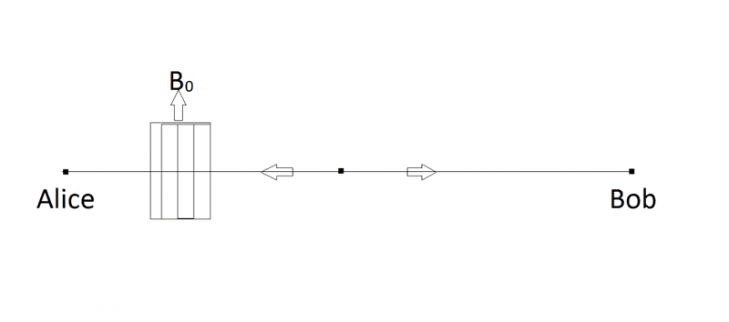

I am not sure that I fully understand even the basic aspects of the Quantum measurement and entanglement but I just came across this thought experiment and I wish to resolve it.
In a setting of two entangled spin-1/2 particles, suppose that Alice applies a uniform magnetic field ##B_0## along ##z## direction at her location. She dose not measure the spin of her particle but because the particle passes through ##B_0## the spin should align along that direction as this is the lowest energy the particle may have. And if she is 100% sure that her unmeasured particle is spin-up, she must conclude that Bob`s particle is spin-down due to conservation of the angular momentum. Now if Bob, however, measures his particle spin and finds that it is spin-down, then he must conclude that Alice uniform magnetic field is directed up and vice versa. Then based on the outcome of his result, he knows the direction of Alice`s ##B_0## which means that Alice can encode any message in the form of 1 and 0 where 1 means ##B_0## is toward the +ve Z-direction and 0 means that ##B_0## is along the -ve Z-direction and this message can be delivered faster than light.
Now suppose a different scenario, 100 pairs of entangled particles are emitted into 2 directions. Alice measures her particles at the same time and it happens that she finds 55 out of 100 particles are spin-up and 45 are down. Bob, who does not measure anything, should have 45 up and 55 down. If Bob put a little coil near his particles, he can picks up a signal which is induced into the coil by that 10 difference in the magnetic angular momentum. So, despite that the Bob system is undisturbed, how the can the laws of angular momentum and energy conservation hold?

No, the position of the uniform magnetic field is before the location of Alice which means Bob can not measure his particle before Alice particle already passes though B0. See the picture.
The relative timing of Bob's and Alice's measurements is irrelevant. Both Alice's magnetic field and Bob have a 50% chance of measuring spin-up, and the entanglement only becomes apparent when they get together afterwards, compare their measurements, and find that one of them measured spin-up and the other measured spin-down.
As PeterDonis and I have already pointed out, passing through Alice's magnetic field is a measurement; that measurement will be properly correlated with Bob's measurement no matter which came first. If Alice measures again after the particle has left the magnetic field (which would be something of a wasted effort - we already know that the particle left the magnetic field in the spin-up state) she will get spin-up, but that result will not be correlated with Bob's - the entanglement was already broken by the first measurement.
(It's worth noting that even if the particles were not entangled, there is a 50% chance of getting opposite results. Alice and Bob would have to run the experiment many times with many pairs of particles and see opposite results every time before they could conclude that the particle source between them is generating entangled pairs).

But how Alice magnetic field has a 50% chance of measuring spin-up and you said in post #2 that Alice particles will be always ended up spin-up which means there is a 100% chance spin-up.
In addition, when you agreed that Alice magnetic field is a sort of measurement and if the outcome of that measurement is always spin-up, why the entanglement disappeared at the very moment of the interaction with ##B_0##? Why does not Bob obtain spin-down all times? Because of the interaction ends the entanglement! then why the Stern-Gerlach device does not end the entanglement and we still have a correlated outcomes between both sides? Because SG device applies a weaker field! does the strength of the field has anything to do with the entanglement?
You have misunderstood what was said in #6. The interaction with the magnetic field is measuring the spin of Alice's particle as it enters the magnetic field, before it it has been forced to spin-up. If a photon is emitted, the particle was spin-down when it entered the field and was flipped up; if no photon was emitted the particle was spin-up when it entered the field. Either way, we have measured the spin of the particle as it was when it entered the magnetic field, and either way the particle leaves the magnetic field spin-up.
Thank you, yes I misunderstood the act of measurement as you said. I thought the outcome of that interaction, which is always spin-up, is the result of the measurement.
