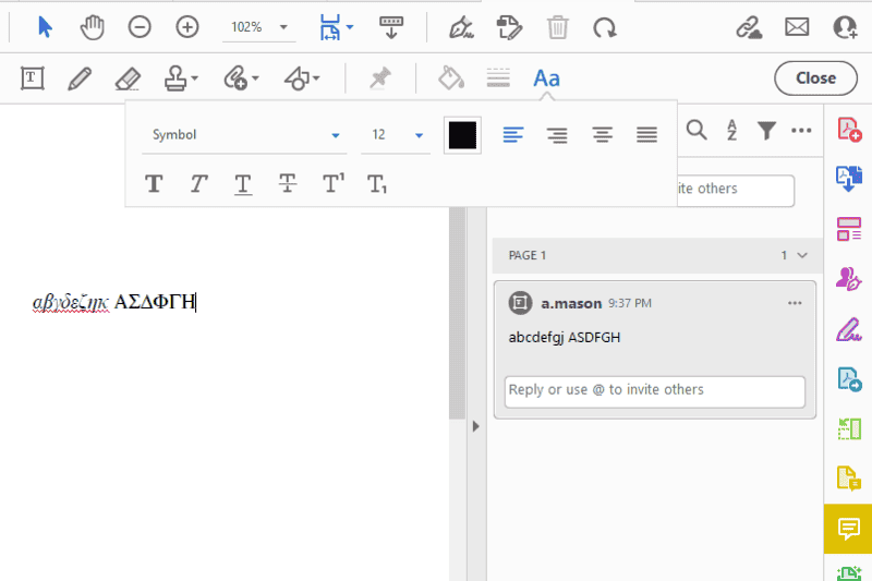

I am working with the pdf of a textbook and often find the need to add comments clarifying some issue for future reference. Can anyone tell me how to add greek alphabet and glyphs like letters with carets for example ^ for unit vectors in a adobe acrobat comments? Thanks in advance!
You should be able to use the
comment to do different fonts. However, the comment summary on the right appears to allow only plain text. For example I did a comment using the
comment and it allowed the Math A and Symbol fonts on the page but not in the comment summary.
However, comments with ##\vec{F} \text{ and } \hat{j}## and other Latex graphics appears to be beyond Acrobat's comment capability.
