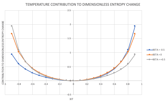

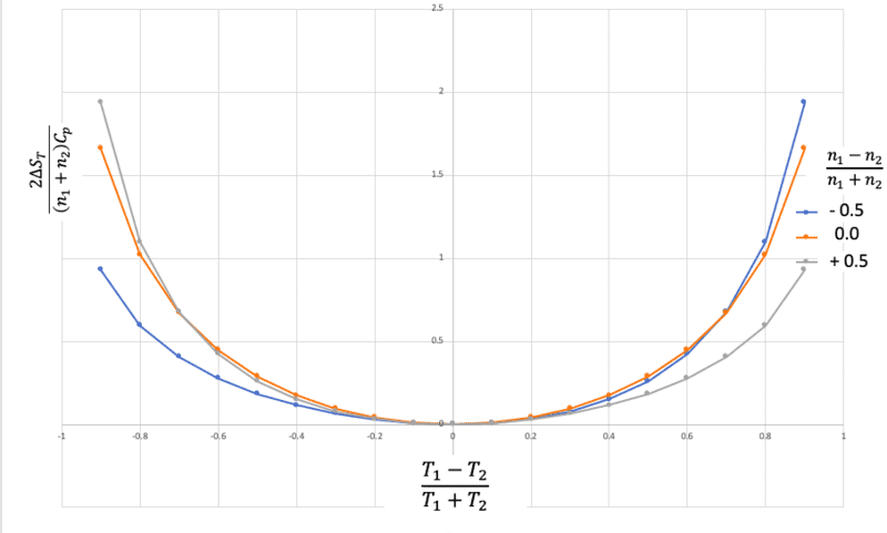

Here is the continuation of the analysis.
As expressed by Eqn. 3 in post #1, the change in entropy of the system experiencing this irreversible process can be expressed as the sum of a temperature contribution and a pressure contribution: $$\Delta S=\Delta S_T+\Delta S_P$$where
$$\Delta S_T=n_1C_p\ln{\left(\frac{T_F}{T_1}\right)}+n_2C_p\ln{\left(\frac{T_F}{T_2}\right)}$$and $$\Delta S_P=n_1R\ln{\left(\frac{P_1}{P_F}\right)}+n_2R\ln{\left(\frac{P_2}{P_F}\right)}$$Expressed in terms dimensionless parameters, these become:
$$\Delta S_T^*=\frac{2\Delta S_T}{(n_1+n_2)C_p}=(1+\xi_n)\ln{\left(\frac{1+\xi_n\xi_T}{1+\xi_T}\right)}$$$$+(1-\xi_n)\ln{\left(\frac{1+\xi_n\xi_T}{1-\xi_T}\right)}$$
and$$\Delta S_P^*=\frac{2\Delta S_P}{(n_1+n_2)R}=(1+\xi_n)\ln{\left(\frac{1-\lambda\xi_P}{1-\xi_P}\right)}$$$$+(1-\xi_n)\ln{\left(\frac{1-\lambda\xi_P}{1+\xi_P}\right)}$$
Based on these, the dimensionless total entropy change is given by $$\Delta S^*=\Delta S_T^*+\frac{\gamma-1
}{\gamma}\Delta S_P^*$$
Note that the dimensionless temperature contribution to the entropy depends only on ##\xi_n## and ##\xi_T##, while the dimensionless pressure contribution to the entropy depends on all three ##\xi_n##, ##\xi_T##, and ##\xi_P##. I have carried out calculations on an Excel spreadsheet to evaluate the dimensionless temperature contribution as a function of its two parameters, and plotted this contribution as versus ##\xi_T## at a selection of values for ##\xi_n## over its allowable range. The results are presented in this Figure:
As can be seen, this dimensionless temperature contribution to the entropy change is positive for all values of its two parameters.
