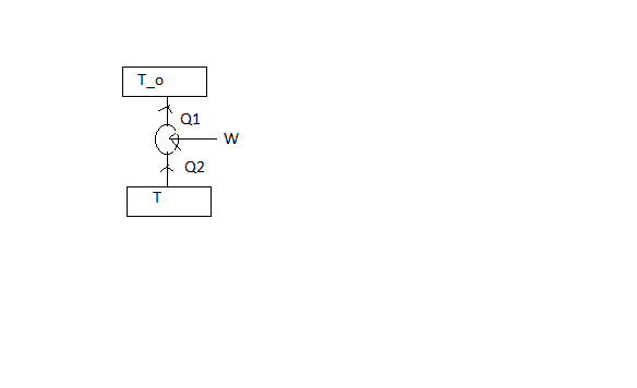

See sketch. So W is the work done by the coolant in extracting heat from the interior of the refrigerator per cycle.
From the efficiency equation, this corresponds to ##Q_1 - Q_2 = W##. So my equation is $$\frac{Q_1}{W} = \frac{T_o}{T_o-T}$$ In this case, ##Q_1## corresponds to the heat transferred to the outside world, which would correspond to the integral of ##\dot{Q}## given in the question. So ##Q = B(T_o - T)t##. Subbing this into my efficiency formula gives $$(T^2 + T_o^2 - 2T_oT)t - T_o \frac{W}{B} = 0,$$ but that is not quite the result.
You're almost there.
Efficiency for a refrigerator is not what you stated. Think again about it. What are you trying to do per cycle, and what is the cost of doing it?

OK, I should have noticed earlier that here W is not the work done per cycle (as conventional) but the work done in unit time.
So instead of Q2 = Q1 - W it's
Q2dot = Q1dot - W
and there's then no "t" in your expression.
You already realize that you have to equate heat removed in unit time to heat entered in in unit time and I think you'll get the right answer this time. (I can confirm the answer.)
