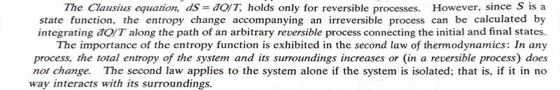

I came across the following statement from the book Physics for Engineering and Science (Schaum's Outline Series).
I cannot seem to find a satisfactory answer to the questions.
  1. Is the statement in above screenshot talking about entropy change the statement of Second Law of Thermodynamics or is it a conclusion based on definition of entropy?
  2. If the statement of entropy change is the Second Law of Thermodynamics, then the entropy change truth needs to be accepted without any questions and we don't need to bother about the reasons why entropy changes occur in the way described. But, I still wonder how can entropy change for an irreversible process increase as per the statement in above screenshot, when this change depends only on the end points of the irreversible process that when joined by a reversible process will yield a 0 change in entropy as per the same statement for the system and it's surroundings.

The statement is messed up, and I disagree with the last sentence in the statement all-together.
When looking at the change in entropy for an irreversible process, you need to separate the system from the surroundings and subject each of them to new reversible paths separately. The reversible path for the system will be different from the reversible path for the surroundings.

As per the first article provided by you, it seems that the entropy change for any real process is less than or equal to the entropy change for a reversible process joining the end points of the real process. Is that what the article is saying? And furthermore, the entropy change is only for the thermodynamic system undergoing the real process and excludes it's surroundings.
Basically, yes.
The surroundings experiences a change in entropy too.. But that has to be calculated as ii the surroundings were a separate system.
It is important to recognize that entropy is a physical property of the material(s) comprising the system, defined at thermodynamic equilibrium. In this sense, it is analogous to internal energy U and enthalpy H. None of these depend directly on the manner (path) by which the material arrived at that state.
There are only two ways that the entropy of a system can change:
1. By heat transfer through the boundary between the system and its surroundings, at the boundary temperature ##T_B##, such that the entropy transferred to the system is the integral of ##dQ/T_B##. This mechanism is present in both reversible- and irreversible processes.
2. By entropy generation within the system ##\sigma##. This mechanism is present only in irreversible processes.
So the entropy change a system for an irreversible process is $$\Delta S=\int{\frac{dQ}{T_B}}+\sigma$$
