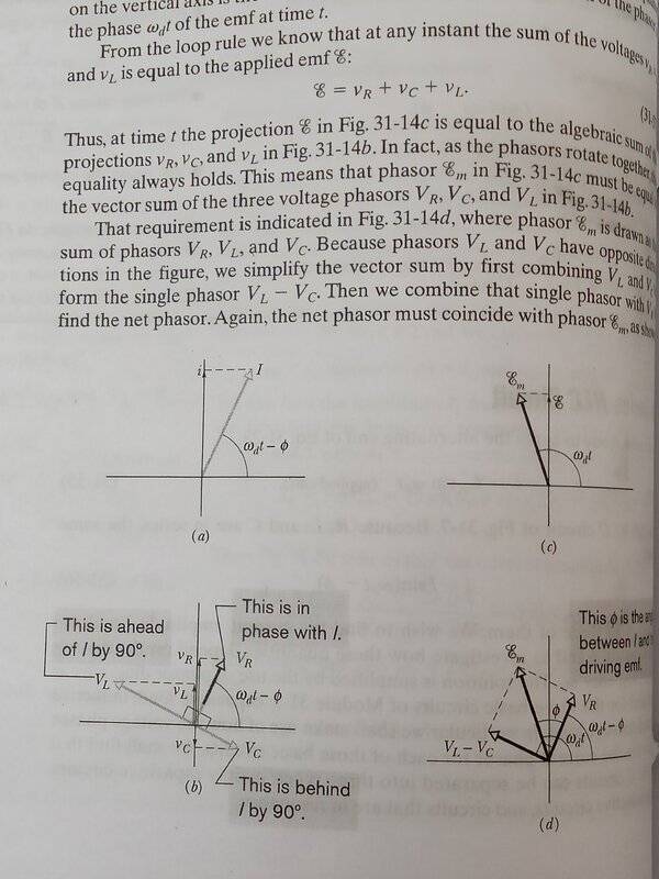

So what we are doing is that we are adding voltages across all components and then equating it to EMF of battery?
Now only thing I am not able to understand is the last step where the denominator is being square rooted.
If ##a, b \in \mathbb{C}##, then the complex number ##z = a/b## has a magnitude ##|z| = |a| / |b|##. What is the magnitude of the complex number ##R-\mathrm{i}/(\omega C) +\mathrm{i} \omega L##, and hence what is the magnitude of ##U_0 / [R-\mathrm{i}/(\omega C) +\mathrm{i} \omega L]##?

Phasors are rotating vectors.
For the example, once one determines the 'phase' between the R, L, and C vectors, they all rotate in sync; a projection off to the right. ie axis-y gives its real value at a particular time t.
I think everyone has seen a vector rotating around the 360 degrees of a circle, with the projection forming a sine wave wrt to time t.
I forget why, maybe it is more visual than the more advanced math, which comes later I believe in the course.
One comment I have is that I'm a little surprised they are projecting the phasors onto the vertical axis instead of the horizontal axis to get the voltages. The way I learned it is the voltage is the real part of ## \tilde{V} e^{ i \omega t} ##, and the projection is along the horizontal axis.
That part of the text isn't shown in the OP, but they must be using ## \mathcal{E}(t)=\mathcal{E}_o \sin( \omega t) ##, instead of ## \mathcal{E}(t)=\mathcal{E}_o \cos(\omega t) ##.

Would it be that they picked the i-vector vertically - so when the R-phasor aligns with i-vector VR = IR, which would be vertical axis projections.
I don't understand what you mean; you can't pick the "i-vector", it's just ##i = e^{i\pi/2} \cong (0,1)##. Also, ##V_R = IR## holds for all time, not just when the ##V_R## phasor is vertical; the ##I## phasor also rotates with time.
The direction of the current axis is vertical is maybe better description.
What do you mean the current axis? There is no current axis, nor is there any voltage axis.
It's just a complex plane, onto which you may plot (time-dependent) complex numbers representing voltages, currents, whatever.
I believe this is why EE's use ##j## for the imaginary ##\sqrt {-1}##.
Also they sometimes graph the (j)imaginary axis horizontally. So care must be taken in communication
Likes 256bits
Right. The basic problem is adding sines or cosines. If Kirchoff's voltage law gives you, for instance,
$$v = v_1 \sin(\omega t + \phi_1) + v_2 \sin(\omega t + \phi_2) + v_3 \sin(\omega t + \phi_3),$$ you can jump through hoops using various trig identities to evaluate the sum, but it's easier if we take advantage of Euler's formula and say $$v = \operatorname{Im}[v_1 e^{i(\omega t + \phi_1)} + v_2 e^{i(\omega t + \phi_2)} + v_3 e^{i(\omega t + \phi_3)}].$$ You can evaluate the sum using algebraic methods or you can represent each complex quantity in the complex plane and use what you know about adding vectors graphically. In general, either of these methods is less work than using trig identities. Once you have the sum, you just pick off the imaginary part and you have your answer. (If you were adding cosines, it's the same basic problem but you take the real part of the sum.)
Unlike the others, I think you should understand and know how to use phasors. It's not that difficult, and the more ways you know how to represent and work with complex numbers, the better. They can make some problems trivially easy. They do come in handy later on when you study wave optics, particularly when you get to single-slit diffraction.

@vela I don't think the issue is at all with phasors/complex numbers, it's more the strange formalism that this book and apparently others seems to use.
It just causes confusions, e.g. for example consider the title of this very thread: "why is the vector sum of peak voltages of circuit elements = peak EMF of the battery"
By labelling the phasors with their magnitudes, OP has likely been misled into thinking that a phasor represents a "peak" of that quantity, when in fact the word "peak" should be removed and the title should instead refer to the time-dependent voltages/voltage phasors themselves [and their time-dependent projections].
The "didactic" presentation in this book obfuscates what should be a very clear and simple treatment with complex numbers, and is ultimately unhelpful IMO.

@Hemant, I feel that you might have been slightly left behind and that perhaps some of the discussion here and some of my earlier comments as well were not helpful for building your understanding. I'd like to try and summarise, just in case you're still a bit confused.
First consider an oscillating voltage ##v = v_0 \cos{(\omega t + \phi_0)}## applied to either a resistor, capacitor or inductor. Through the component a current will flow, oscillating each time at the same angular frequency but with perhaps an additional phase ##\varphi##, that is ##i = i_0 \cos{(\omega t + \phi_0 + \varphi)}##. Let's consider the AC response for resistors, capacitors and inductors in turn:$$\begin{align*}
\mathrm{R}: &\, i = \frac{v}{R} = \frac{v_0}{R} \cos{(\omega t + \phi_0)} \\ \\
\mathrm{C}: &\, i = \frac{dq}{dt} = C \frac{dv}{dt} = -\omega C v_0 \sin{(\omega t + \phi_0)} = \omega C v_0 \cos \left(\omega t + \phi_0 + \frac{\pi}{2} \right) \\ \\
\mathrm{I}: &\, i = i(0) + \int_0^{t} \frac{di}{d\xi} d\xi = i(0) + \int_0^t \frac{v_0}{L} \cos{(\omega \xi + \phi_0)} d\xi = \frac{v_0}{\omega L} \sin{(\omega t + \phi_0)} = \frac{v_0}{\omega L} \cos \left( \omega t + \phi_0 - \frac{\pi}{2} \right)
\end{align*}$$You may notice that the resistor response is in phase with the voltage, whilst the capacitor and inductor responses are ##\pi / 2## ahead and behind the voltage respectively.
It is convenient to introduce the complex voltage and complex current, defined by ##V = V_0 e^{i \omega t}## and ##I = I_0 e^{i \omega t}## respectively, where ##V_0 = v_0 e^{i \phi_0}## and ##I_0 = i_0 e^{i (\phi_0 + \varphi)}## are complex amplitudes encoding the magnitude and initial phase. The ##\mathrm{Re}## function maps from the complex voltage/current and standard voltage/current, that is, ##v = \mathrm{Re}(V)## and ##i = \mathrm{Re}(I)##. One helpful property to remember is that the ##\mathrm{Re}## function commutes with time-differentiation; given some ##z: \mathbb{R} \rightarrow \mathbb{C}## with ##t \mapsto z(t)##, you can write ##z(t) = a(t) + ib(t)## and thus$$\mathrm{Re} \left( \frac{\mathrm{d}z}{\mathrm{d}t} \right) = \mathrm{Re} \left( \frac{\mathrm{d}a}{\mathrm{d}t} + i \frac{\mathrm{d}b}{\mathrm{d}t} \right) = \frac{\mathrm{d}a}{\mathrm{d}t} = \frac{\mathrm{d}\left( \mathrm{Re}(z) \right)}{\mathrm{d}t} $$What this means is that you can do all the differentiations in complex numbers, and convert everything back only at the very end.
Now, consider a "black box" consisting of some network of resistors, inductors and capacitors. It may be assigned a (complex) impedance ##Z##, which you may think of loosely as a complex analogue of resistance, and is defined as the ratio ##Z := V / I##. For example, for the resistor you simply have ##I = V/R## and thus$$Z_R = \frac{V}{I} = R$$then for the capacitor, you have ##I = C \frac{dV}{dt} = i\omega C V_0 e^{i \omega t} = i\omega C V## and thus$$Z_C = \frac{V}{I} = \frac{1}{i\omega C }$$and for the inductor, you have ##V = L \frac{dI}{dt} = i\omega L I_0 e^{i \omega t} = i\omega L I## and thus$$Z_I = \frac{V}{I} = i \omega L$$How do you combine impedances? Let's just do one example, e.g. say ##N## impedances ##\{Z_1, \dots, Z_N \}## in parallel. The complex voltage ##V## across each of these is the same, and the sum of the complex currents through each must equal the total current into the parallel network, hence$$\sum_{k=1}^{N} I_k = V\sum_{k=1}^{N} \frac{1}{Z_k} = \frac{V}{Z_{\mathrm{eff}}}$$which upon division by ##V## yields the familiar formula.
You might wonder, do all of Kirchoff's laws, and the rules you know for analysing circuits hold also on the complex amplitudes ##V_0## and ##I_0##? Yes! For example, consider the current law applied to a junction with ##N## inputs, $$(\forall t \in D) \quad \mathrm{Re}\left( \sum_{k=1}^N (I_0)_k e^{i \omega t} \right) \implies \sum_{k=1}^{N} (I_0)_k = 0$$because the only way for the sum to be zero for all values of ##t## is if the sum of the complex current amplitudes themselves vanish. The same analysis holds for the voltage law.
Why is this formalism useful? Well, let's consider your example of a circuit containing a resistor, capacitor and inductor in series, connected across an oscillating voltage source. You already know from the "impedances in series" principle that the resulting impedance is$$Z = Z_R + Z_L + Z_C = R + i \left(\omega L - \frac{1}{\omega C} \right)$$From this it's not hard to write down the current,$$I = \frac{V}{Z} = \frac{V}{R + i \left(\omega L - \frac{1}{\omega C} \right)} = \frac{V e^{- i \phi_Z}}{\sqrt{R^2 + (\omega L - \frac{1}{\omega C})^2}}$$where the phase shift ##\phi_Z## is given by$$\phi_Z = \arctan \left( \frac{\omega L - \frac{1}{\omega C}}{R} \right)$$With this we can now work out some interesting quantities. For instance, what is the rate of energy dissipation in this oscillator, due to the resistor? You have$$\langle P \rangle = R|I_0|^2 \langle \cos^2{(\omega t - \phi_Z)} \rangle = \frac{1}{2}R |I_0|^2 = \frac{R|V_0|^2}{2(R^2 + (\omega L - \frac{1}{\omega C})^2)}$$At resonance, ##\omega_0 L - \frac{1}{\omega_0 C} = 0##. Half-power thus occurs when ##\omega_h L - \frac{1}{\omega_h C} = \pm R##, or in other words when$$\omega_h = \mp \Gamma + \sqrt{\Gamma^2 + \omega_0^2}$$with ##\Gamma := R/2L##. Then, you may identify the full-width half-power as ##\delta \omega = \frac{R}{L}##, which results in a quality factor ##Q = \frac{\omega_0}{\delta \omega} = \frac{1}{R} \sqrt{\frac{L}{C}}##.
In other words, complex numbers allow you to fairly easily analyse key properties of oscillating circuits, and oscillating systems in general.
