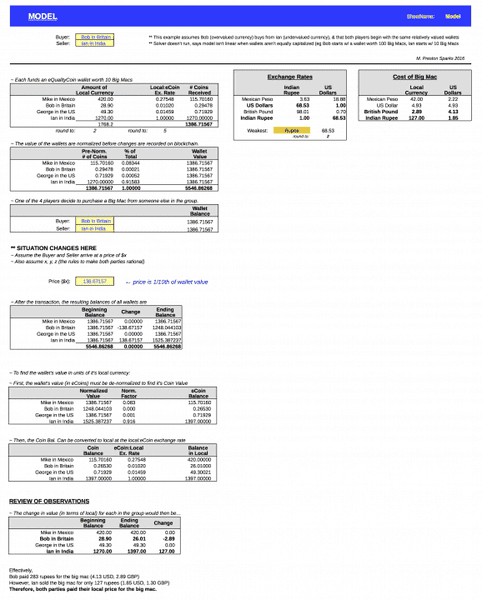

I've been working on developing a crypto-currency called eQualityCoin for a while now and hoped someone here might be able to help me "classify" the system in a formal mathematical sense.
The system's main feature is a simple rule for how it determines a purchaser's exchange rate. More specifically, if the purchaser's native/local currency is the "weakest" in the system then their exchange rate is 1:1. If the purchaser's native currency isn't the weakest, their rate is the inverse of the exchange rate of their currency to the weakest. This formula produces a "pre-normalized" value of eCoins. This value is then normalized by dividing the pre-normalized coin balance by the wallets weight (that is, it's ratio to the pre-normalized wallet universe as a whole). The normalization aspect allows user's who fund their wallets in different base-currencies to have an apples-to-apples view of the wallet's value.
I'm attaching a model I put together (which is basically a thought experiment) to try and study how the system behaves. In the model, the players fund new wallets with different base-currencies which are equally valued (in relative terms of purchasing power). To do this, I used The Economist's "Big Mac Index"; i.e., each player funds a wallet worth 10 Big Macs. Then, two players (using eCoins) agree to the exchange of 1 Big Mac. After the transaction occurs, the players convert their wallets back into units of their base-currency.
What I found is this- although the two players agree to the same price (in eCoins), once their wallets are converted back into their local currency, the price the players actually pay/receive is the same price of the good locally, in units of their local currency.
This leads me to believe that the system would price goods at purchasing power parity (I know this is an econ concept and not a statistical one, but I think it's helpful to get the point across).
If anyone could help point me in the right direction I'd greatly appreciate it. I'll rephrase my question:

Thanks for the feedback Fooality. I've attached a screenshot of the spreadsheet, hope it works for you.
My motivation was to try and find a way to remove the price volatility from BitCoin. In other words, I want to be able to buy $100 USD worth (or any currency) of the Coin, and be certain my "wallet" will still be worth $100 USD a year from now, regardless of changes in the exchange rate of the USD.
Basically, when a user funds a new wallet, they specify what type of currency the wallet is funded with. The wallet can only be converted back into it's own currency type. I have flowcharts that show the process (I'll upload that as a separate reply).
I would say it is immune to manipulation, because in order to change the Coins exchange rate the manipulator would have to pour money into the weakest currency, which would elevate the system as a whole. Also, I can share some supply/demand curves I made using the model that show it would facilitate fair trade in that it removes what's called a "deadweight loss" in econ. Then again, though, if I could classify the model in a formal mathematical sense, I think others would be able to provide better justifications than mine.

Looked like my image was blurry, try this..
Thanks for that. Fair warning, I'm probably too naive in econ to really offer much, but I want to understand it.
So the basic thumbnail sketch is that day to day currency exchange rates are effected by things that make them deviate from what the rate would be based purchasing power parity, so the result is a different cost of a big mac, in absolute terms (not just nominal), in different places. By using eQualityCoin as an expression of those absolute terms, you can actually bypass that, and have each person in different countries buy a big mac from the other, each at their local cost in absolute terms, instead of the exchange rate distorted by those other factors. Do I have the basic idea?
