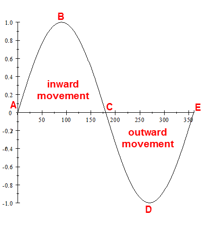

The piston moves back and forth around its mean position in a sinusoidal fashion as shown below. We have established that the temperature stays constant which means all the added energy is taken out which implies some kind of a heat sink but let's ignore it.
From A to B, as the piston moves inward, it collides with the gas molecules and the intensity it pushes the molecules with depends upon the rate of change, i.e. derivative of its movement. This movement generates a series of compressions and it results in rise in temperature.
From B to C, it starts going back toward its mean position, it generates a series of rarefactions and it results in decrease in temperature. The same thing happens from C to D.
From D to E, a series of compressions is generated and it results in rise of temperature.
If we follow what I'm saying then it'd mean that over one complete cycle of the piston, there shouldn't be any change in temperature. But I'm sure this is wrong because the piston does add energy to the gas which results in rise of temperature.

From A→B piston runs directly and forcefully into the molecules and pushes them back, i.e. compressions. As the piston runs into them, it comes into contact with lots of atoms/molecules. When the piston is moving back, i.e. B→C, molecules would come into contact with piston but not as many as during A→B, and also the piston is no longer running into the molecules. During B→C some of molecule would loose some of their speed, which results in decrease in temperature and hence loss of energy. But the main point is that energy supplied during A→B phase is way more than energy lost by gas molecules during B→C
In case of A→B the bat is fast moving toward ball and at the same time ball is rushing toward the bat. In case of B→C the bat is moving away from the ball.
From C→D the gas molecules keep on loosing some their energy but from D→E the piston once again starts hitting the molecules very forcefully which means supplying them with a rather large amount of energy. During D→E the gas is at lower pressure compared to A→B therefore energy added would be a little less than compared to A→B.
Therefore, we can see that overall one complete cycle of piston adds energy to the system.

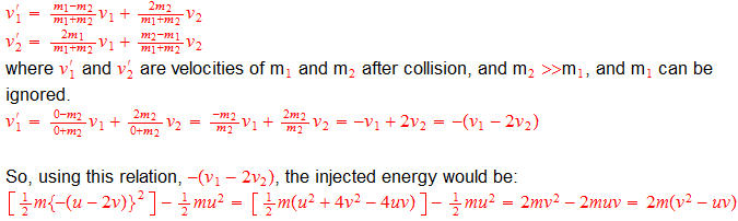

1. In a collision between an object O1 of tiny mass m moving left at speed u and a massive object moving right at speed v, the leftwards component of velocity of the tiny object changes from u to -(u+v). So the kinetic energy increases from ##\frac12 mu^2## to ##\frac12 m(u+v)^2## so that the injected energy is ##\frac12 mv(v+2u)##. This is dominated by the square of the piston's speed v. The average of the square of a random variable is greater than the square of its average.
2. What matters is not the raw average over time, but the average weighted by collision rate. Collision rate will be higher when the piston is moving in from what it is when it's moving out.

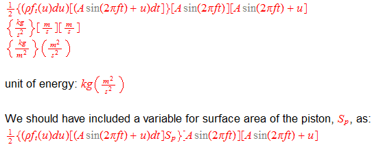

I was trying to apply dimensional analysis but the units don't match up.
I believe the units for
should be kg/s or informally mass/s.
You can see below that I'm ending up with mass/ms which is wrong.
Where am I going wrong?You also say that closing speed of piston with those particles is
. I understand that the magnitude of the velocity difference at impact is called the closing speed.
If piston is moving is moving toward right, let's say this is positive velocity. Then the particle would be moving toward left, it'd be negative velocity. So, we can write the expression
which is same as your expression. But there is a problem. There could be molecules/particles which are also moving rightward as the piston with speed less than that of the piston so the collision would take place. How do we take care of such particles? Does the expression include such cases? Can we ignore them?
Thank you!

Re dimensional analysis, the units of the three factors in the expression ##(\rho f_t(u)du)(A\sin 2\pi ft+u)dt##
are ##(\textit{kg}\,m^{-3})(m\,s^{-1})s##, which simplifies to ##\textit{kg}\,m^{-2}##, which are the correct units for the mass colliding with the piston per square metre of piston surface area, in the time interval ##(t,t+dt]##. If we multiply that by the surface area of the piston, which has units ##m^2##, we get the kg of mass colliding in that time interval.
They are included by our using a lower limit of integration that depends on the velocity of the piston. That lower limit ensures that we include all particles that are moving rightwards no faster than the piston. See the third last para of post #13.

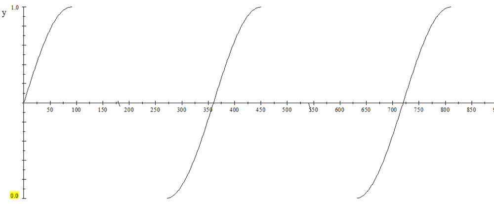

I was trying to do the numerical integration but came across few problems.
I'm sorry but it's not sitting well with me. I'm familiar with the two equations below about two masses colliding with each other.

I understand that one can say that if the surface area is taken to be unity then Sp could be ignored but it won't be right, in my humble opinion.
The final equation below is an equivalent of the quoted equation above. Right?
\frac12
(\rho f_t(u) du) ( (A\sin 2\pi f t + u) dt)
(A\sin 2\pi f t) ((A\sin 2\pi f t) + u)
Aren't we missing a factor of "2"?
