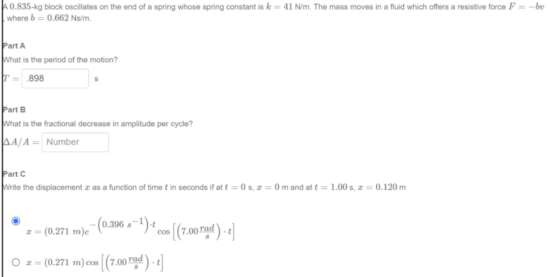

A 0.835 -kg block oscillates on the end of a spring whose spring constant is k=41 N/m. The mass moves in a fluid which offers a resistive force F=−bv , where b=0.662 Ns/m.
##x(t) = Ae^{\gamma*t)*cos(\omega*t + \phi)##
yooo.
Some help on the following problem would be much appreciated.
I don't get how to solve the two equations I obtained for the COIs A and phi.
calculated: ##\omega == 7rad/s## and ##\gamma = 0.396s^-1##
for part C
we have two initial conditions:
at t = 0 > ##0 = Acos(\phi)##
at t = 1s > ##0.12 = A*e^{0.396}*cos(7 + \phi)##
Do I need to use trig identities or sometin?
https://www.physicsforums.com/attachments/304960
You should be able to find ##\phi## quickly from your first equation if you noticed that ##A## can't be zero (or can it be, what are your thoughts on this?)
Then once you know ##\phi## you can find ##A## from your second equation.

Hello, thank you for the response.
Indeed A cannot be 0 otherwise, there'd be no oscillation.
But I don't how I'd calculate ##\phi## from eq. (1), of course I know it's good for 3pi/2 and pi/2 but the problem is that I didn't see such an option in the multiple-choice selection, so I thought that it'd perhaps be some relation between the two equations. (i.e. they all just say ##cos(7t)## at the end)
And for ##\omega_0## what do you mean? it is calculated by ##\omega = \sqrt{\frac km + \frac {b^2}{4m^2}}##

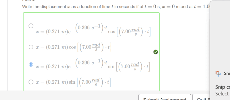

oh dear god... my apologies there are sines in the multiple choices... didn't look through it. apologies, I'll try work it out now. Thanks.
Likes Delta2
Your original image does not show all of the options. You are supposed to post the entire question. That includes the options.

Did you solve the problem yet?
What were the other multiple choice options?
Likes Delta2 and link223
yep, forgot to post.
Likes Delta2
As I suspected. You do not need to do any computations at all to discard all of the wrong answers:
- The first two can be discarded because they do not satisfy x=0 at t=0.
- The last and the second can be discarded because there is no damping term, just harmonic oscillation.
(So the second alternative is discarded by both arguments)
In multiple choice questions it often helps to first stop and think about if you can trivially rule out some alternatives by simple arguments. This often shows more understanding of the underlying physics than blindly entering into the algebra.

true you're right, I actually thought about as there won't be no multiple choice on the exam so most of the time I go straight for the analytical method.
Thanks for this pov.
also .. I actually forgot to ask..
I get ##\phi = \frac{\pi}{2}## and then ##cos(\omega + pi/2) = -sinx## ? but I think I got a negative answer for that second eq. to calculate A. and at part C you don't see any - sign ??
isn't it ##cos(-(pi/2 - x)) = sinx?## where we write a positive ##\phi## as ##cos(x - \pi/2)##
I mean.. if I get ##phi = pi/2## which is to the right in a sinosoidal func. don't I get ##cos(\omega - pi/2)## which is equal to## sin \omega##
But.. the position is written as ##x = Acos(\omega t + \phi)## with a ##+## instead of a ##-##
Yes you right you get negative A but the minus sign is neutralized by the other minus sign of ##\cos(\omega t+\frac{\pi}{2})=-\sin\omega t##

Sorry I have lost you, the equation of position is $$x=Ae^{-0.396t}\cos(7t+\frac{\pi}{2})$$ in which if you replace ##A=-0.271## and ##\cos(7t+\frac{\pi}{2})=-\sin7t## you get option C of post #15.

You can pick either pi/2 or 3pi/2. It does not matter for the end result. All that will occur is that you reshuffle a minus sign into the constant A. All that matters for the solution is the product of A and the sine.
Likes link223 and Delta2
owh right! my bad... okay yeah I forgot about the sign for A of courseee... thanks a lot.
