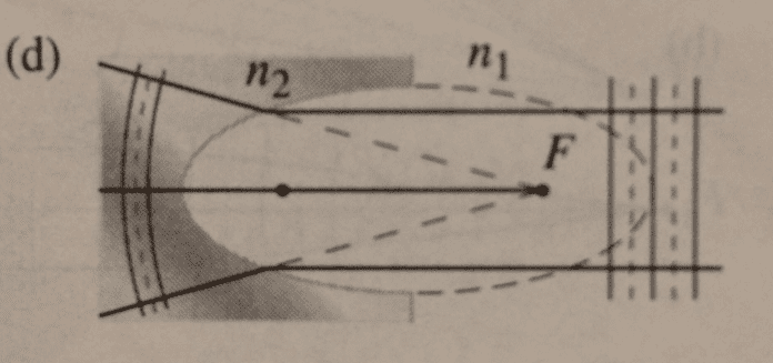

I am given the following figure:
These are converging rays that appear to be going to a point F convert to a plane wave upon hitting the boundary between n2 and n1, and I am asked to find the equation for the boundary between n1 and n2 that perfectly accomplishes this conversion to a plane wave. Assume the distance between the vertex of the boundary and the point F is a known quantity.
I believe the answer is 1/f = 1/n1 + 1/n2
But I am not sure how to get to this answer. Could someone please explain the steps and help me understand the problem? Thanks.
I believe that the material ## n_2 ## needs to be higher index than ## n_1 ## and the necessary shape (the boundary between ## n_1 ## and ## n_2 ##) will be an ellipsoid. Showing this would take some calculus and application of Snell's law at the boundary. Derivations such as this with ellipsoids (in this case a 2-D ellipse would suffice), are non-trivial and require considerable effort. (The lensmaker's equation 1/f=1/b+1/m will not produce the necessary result.) In this case you need to take a ray that is pointed at the far focus and show with proper choice of "a" and "b" for the ellipse (for a given n1 and n2) that the ray will necessarily come out pointing horizontal.

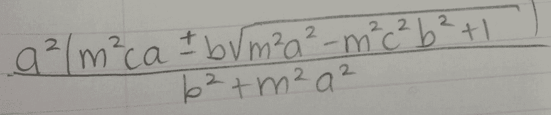

The algebra is getting me confused, I can't get an intersection point because my equation is too hard to simplify. If I use wolfram alpha it gives me that x=+a and x=-a. I also don't understand what you mean when you say find the ellipsoid mp
## y=mx-mc ## intersects the ellipse at two points. Substituting into the equation for the ellipse, it is a simple quadratic expression that you can solve for the point(s) of intersection.

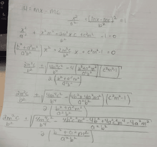

Where am I going wrong?
At this point I stopped because I figure I must have messed up somewhere before this

I think you correctly applied the quadratic formula. These problems simply are non-trivial. I had previously ( a number of years ago) worked a similar problem where an ellipsoid (with higher index inside and air outside) is used as a focussing element and incident parallel rays converge at the second focus. The algebra is non-trivial, and you need to get every "+" and "-" sign correct in order to get the correct result. editing... because of the azimuthal symmetry it is sufficient to work the problem in 2 dimensions... Even in the simplified 2-D version, it is quite difficult.

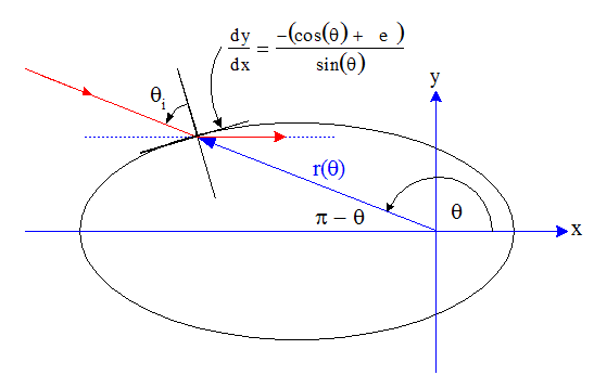

I'm not about to attempt this problem myself, but I can imagine that starting with a polar form for the ellipse might be beneficial. In particular,
##r(θ) = \frac{p}{1 + e~cos(θ)}##
where ##p## is a constant (also known as the "parameter" in geometry or the "semi-latus rectum" if you're studying orbits), and ##e## is the eccentricity of the ellipse.
The angle θ is measured from the positive x-axis, and the focus of interest is the origin. The immediate benefit is that the radius vector will lie along the ray that intersects the ellipse. So no hunting for the intersection. All the angle magic occurs at the end of the radius vector.
