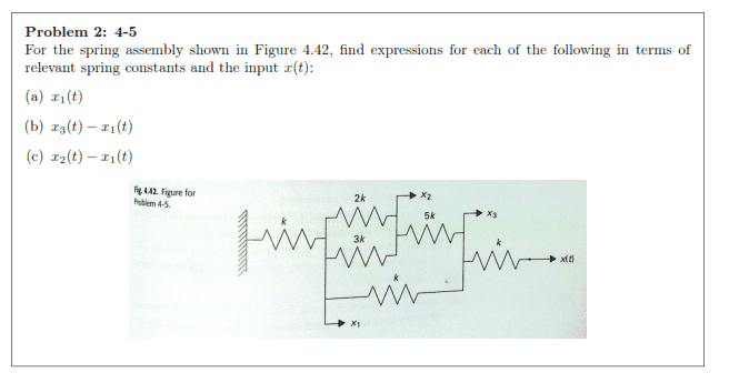

Equation of motion for a massless spring system
In summary, the force due to a spring is given by the sum of the forces on the nodes it is connected to.

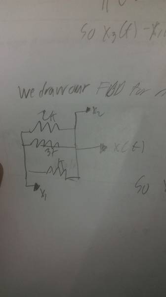

a. FBD:
The force goes through the nodes, and the sum of the forces must be 0 because the nodes are massless. Therefore, kx_1 = x(t)
So x_1(t) = x(t)/k

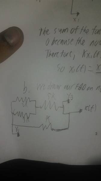

b. FBD:
For this system, the parallel springs have a k_eq of k + 2k + 3k = 6k. This is in series with the 5k spring, so the k_eq for both is 1/k_eq = 1/5k + 1/6k
= 5/30k + 6/30k
=11/30k
So k_eq = 30k/11.
Therefore, 30k/11(x_3 – x_1) = x(t)
So x_3(t) – x_1(t) = 11x(t)/(30k)
c. FBD:
Since the k_eq = 2k + 3k +k = 6k,
6k(x_2 – x_1) = x(t)
So x_2(t) – x_1(t) = x(t)/(6k)
Is my way of thinking correct?
I don't think your thinking is correct. Please write a force balance on each of the nodes. You will then get a set of linear equations that you can solve for each of the nodal displacements in terms of x(t). You should end up with three equations in three unknowns.

No. For the force balance on node 1, I get:
[tex]kx_1=5k(x_2-x_1)+k(x_3-x_1)[/tex]
or, equivalently,
[tex]7x_1-5x_2-x_3=0[/tex]
Can you do similar force balances for nodes 2 and 3?

Actually, no. Choosing Node 1 as a free body, there are 4 springs connected to node 1. These are exerting the only contact forces on node 1. One of them has a spring constant of k, and is connected to the wall. One has a spring constant of k, and is connected to node 3. Two of them have spring constants of 2k and 3k, respectively, and are connected to node 2. Do you see which springs I'm referring to? In terms of the nodal displacements x1, x2, and x3, what are the tensions in each of these springs? Write a force balance on node 1, based on these tensions.

It looks like you have the right idea now (nice work), but there are some sign errors.
Node 2: 5k(x_2 - x_1) = 5k(x_3 - x_2)
Node 3: 5k(x_3 - x_2) + k(x_3 - x_1) = k(x(t)-x_3)

All three of the displacements x1, x2, and x3 are taken as positive to the right. What we need to do is calculate the increase in length of each of the springs based on the displacements at its two ends. This determines the tension in the spring. So, if a spring is connected between nodes 1 and 3, for example, its increase in length is x3 - x1. In this problem, it's the displacement of the node at the right minus the displacement of the node at the left.

No. That's not what they are looking for. They are looking for x_1 expressed solely in terms of x(t).
You have 3 simultaneous linear algebraic equations in three unknowns: x_1, x_2, and x_3. Solve this set of equations for x_1, x_2, and x_3, each solely in terms of x(t). I'm certain that you have learned how to do a math problem like this.
