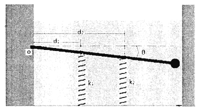

A small ball with mass M attached to a uniform rod of mass m and length l pivoted at point o and attached to two springs with spring constant k1 and k2 at distance d1 and d2 from point o as shown in Fig 2. The system oscillates around the horizontal line. Assume the system is in a fluid and is damped by a viscous drag force proportional to the speed. Find the equation of motion for the small angle oscillation and its solution if it starts from rest with initial angular position θ0. Find the quality factor. Ignore the buoyancy force.
[/B]
Moment of inertia for rod: Irod = (1/3)*m*l2
Moment of inertia for ball: Iball = M*l^2
Equation for torque: τ = I*θ''
Drag force: FD = -b*cosθ
Spring force: FS = -k*sinθ
Small angle approx for sin: sinθ = θ
and for cos: cosθ = 1

Don't worry about the CM location; take moments about the left end. It will all work out quite easily.

First, from the integral definition of MMOI, it is evident that these terms simply add. Thus the total MMOI with respect to the left end is simply the sum of the MMOI for the rod + MMOI for the lumped mass. You have both of these terms.
When the system is displaced downward by θ as shown in your diagram, the compression in spring 1 is (approx) d1*θ, so the force in this spring is F1 = K1*d1*θ and the moment of this force about the left end is M1 = d1*F1 = K1*d12*θ. A similar analysis applies for the second spring.
I leave it to you to figure out how to put it all together and take the damping into account. (Be brave, go ahead!)

Okay, so it seems like you're saying Itotal = l2(m/3 + M)
And we can sum the torques... so Ttotal = k1d12θ + k2d22θ + b*l*θ' ? I'm not sure about the drag part. I know the drag force is bθ', but converting that to torque by multiplying by l seems weird since it's not a point force, and would be distributed unevenly across the rod and mass.

Since you're not given a drag coefficient, you can just write the drag torque as ##-b\dot\theta##. The 'b' encompasses the distribution of the drag along the rod and ball.
I think I've got it now, but for the drag I ended up integrating over the length of the rod:
[itex]\int_{0}^{l}-br\theta'dr = -\frac{1}{2}bl^{2}\theta'[/itex]
Which seems right since it gives units of torque (the [itex]l^{2}[/itex] term).

OK, but since you are inventing b and l is constant you might just as well have invented ##c = \frac{1}{2}bl^{2}##. And why the sign flip?

The sign flip was a typo, and I did have 1/3 initially but fixed it so that probably explains the bug.
The [itex]l^{2}[/itex] term here actually ends up cancelling out when you divide through by the moment, [itex]l^{2}(m/3+M)[/itex].
I did absorb the 1/2 term into the b, which I hope is an okay liberty to take.
