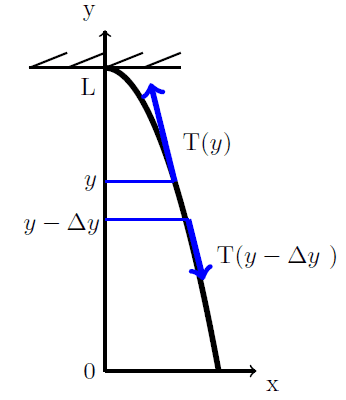

Derive the equation of motion of a chain whose supporting point moves vertically with motion Y(t).
Assume displacement of the chain in the vertical y direction is much smaller than the chain length.
Thus displacement of the chain happens only in the x direction.
u is the transverse displacement, g is gravity, L is the chain length and ##\rho## is the mass density per unit length of the chain. ##\hat{x},\hat{y}## are the unit vectors along the x and y directions.
In the figure assume the "ceiling" moves with motion ##Y(t)##, i.e. it is a point support.
Applying Newton's law in the vertical direction
##T(y).\hat{y}=\rho y[g+\frac{d^{2}Y}{dt^{2}}]##
If ##\theta## is the angle between ##T## and ##\hat{y}## that means ##|T|\cos\theta=\rho y[g+\frac{d^{2}Y}{dt^{2}}]##
In the horizontal direction
##[T(y)-T(y-\Delta y)].\hat{x}=\rho\Delta y\frac{\partial^{2}u}{\partial t^{2}}##
Taking the limit ##\Delta y\rightarrow 0##
##\frac{\partial}{\partial y}[T(y).\hat{x}]\equiv \frac{\partial}{\partial y}[|T(y)|\sin\theta]\equiv \frac{\partial}{\partial y}[\rho y[g+\frac{d^{2}Y}{dt^{2}}]\tan\theta]=\rho y\frac{\partial^{2}u}{\partial t^{2}}##
since ##\tan\theta=\frac{\partial u}{\partial y}## the equation of motion is (assuming ##\rho=constant##)
##(g+\frac{d^{2}Y}{dt^{2}})\frac{\partial}{\partial y}[ y\frac{\partial u}{\partial y}]=y\frac{\partial^{2}u}{\partial t^{2}}##
Is this right? In particular should I include the acceleration of the supporting point moving vertically (##d^{2}Y/dt^{2}##)?

In the diagram, the top appears attached to a ceiling. Is that supposed to be moving as Y(t)? If it moves down fast it will contact other parts of the chain. I feel it should be a point support.
Is this a typo: "Thus displacement of the chain happens only in the x direction"? Should it say in the y direction?
Your first equation seems wrong. Shouldn’t you be applying it just to an element of the chain (so it's the difference in the tensions) and not assume it has the same acceleration as the support?

Ceiling: Yes it should be a point support, the drawing is a bit misleading.
Displacement meaning as far as the transverse displacement of the chain. The chain as a whole does move vertically but its elements relative displacement is negligible vertically (thats how I understand it).
Thinking about the first equation is wrong...
Yes, but more importantly, the fact that the vertical displacements are small means the horizontal displacements that result are much smaller and should be ignored. If you consider the slope of an element length a as dθ then the vertical end-to-end displacement is a sin(dθ) ≈ adθ, whereas the horizontal shrinkage is a(1-cos(dθ))≈ a(dθ)2/2.
This means you can identify a physical element of the chain as being from x to x+dx. What is its mass?
And y=y(x,t).
Likes Jenny Physics

Ah, I see I have quite misinterpreted the set up. Partly I was misled by the diagram.
But I'm not sure what the diagram should look like. Since the motion is driven by displacement in the y direction, it is nonsense to say the displacement is only in the x direction. Whether the lateral displacement exceeds the vertical displacement depends on the magnitude of ##\ddot Y##. If it is always less than g then there will be no lateral movement.
Perhaps it means we can ignore the local variation in vertical displacement, i.e. treat it as almost Y everywhere.
Which way it will displace laterally at any point is a matter of chance. In practice, it seems likely to produce chaotic motion.
Maybe I am still missing something, but it seems like an awfully ill-defined question to me. @PeroK, @BvU, @kuruman, @TSny, @Steve4Physics: can any of you suggest how we should read this?

By the Hamilton principle I have got the following
$$u_{tt}=g(t)(xu_x)_x$$
it is accomplished under assumption that ##|u|,|u_x|## are small and the vertical velocities are small relative the moving frame;
y=u(t,x) is the shape of the chain relative the moving frame
UPD: I directed y horizontally ; x -- vertically down and the origin is at the pending point
Likes Jenny Physics

Yes it is ill-defined. I believe the intention of small vertical displacements means ##Y(t)## is small as well (as in a small oscillation of the supporting point say).
