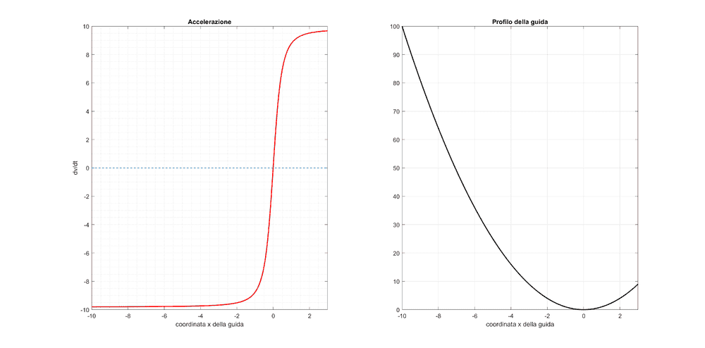

In the following picture I took a guide of equation y = x^2 and I've chosen an interval I = [-10, 3]. On the left picture you can see the tangential acceleration plotted against the x coordinate (as you can see in x = 0 no acceleration at all, while for big |x|, the tang. acceleration tends to become vertical so to the value 9.81), while on the right picture you can see the actual shape of the track y = y (x).

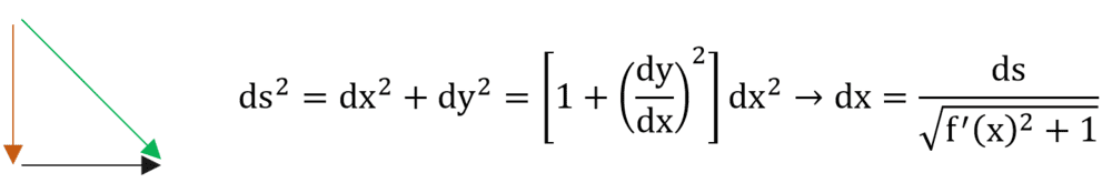

But then the problem that arises is how to link the coordinate x with the movement on the guide, called s. Suppose the marble moves 1 unit on the track, then you need to relate that motion to the guide x coordinate.
What I wrote was:
That is: the infinitesimal movement on the guide (green) is equal to the square root of the sum of the infinitesimal vertical movement squared, brown, and the infinitesimal horizontal movement squared, black.
So now I have a relationship between dx and ds.

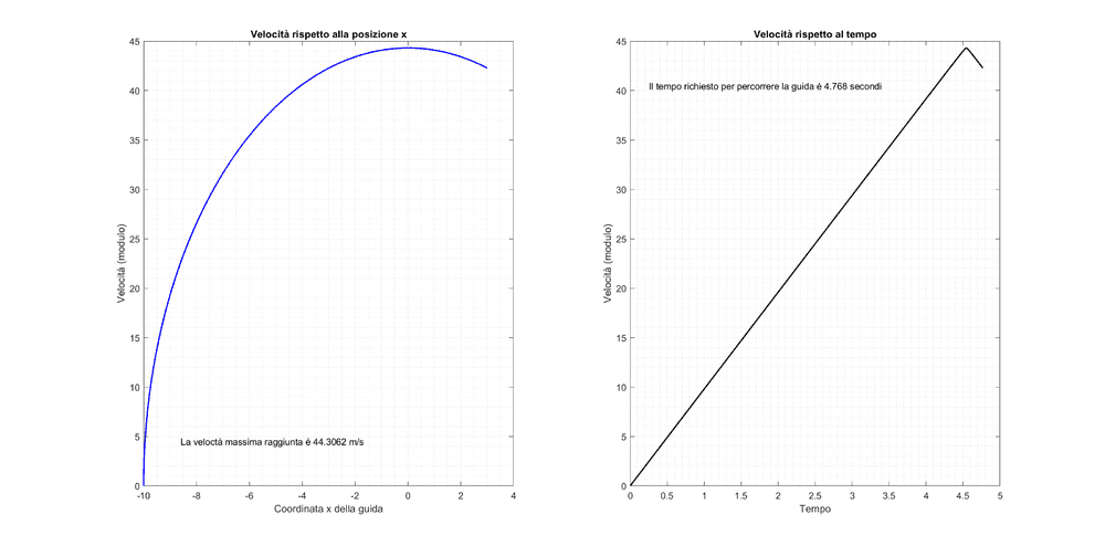

These are the results I have found for this specific problem (obtained for a dt = 0.001 seconds). On the left, a graph represents the velocity vs the x coordinate. The note says that the maximum reached speed is 44.3062 m/s and this is consistent with the well known equation of a falling object v = sqrt (2 g h), where h in this case, is the height at the point of maximum speed, i.e. 100 m.
On the right plot is depicted the speed against time. The time required to complete the path is 4.768 seconds and also this is quite consistent if you compare it to the time required for a body to free fall from 100 m to zero.

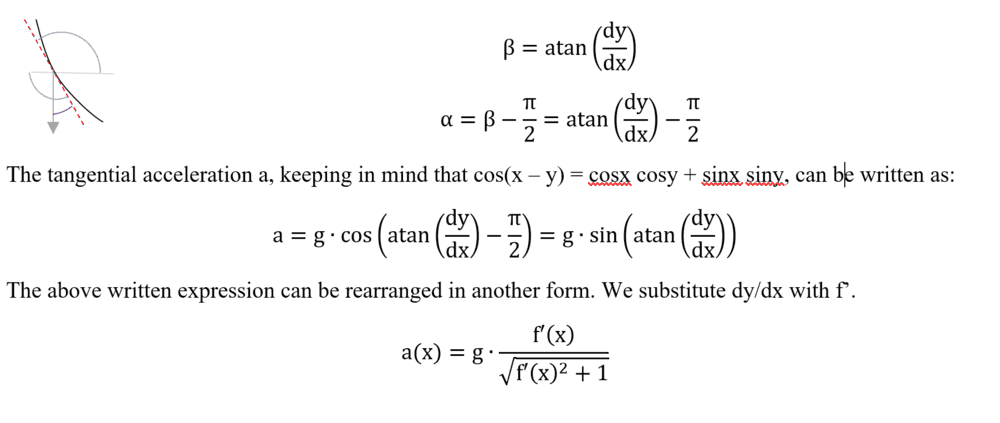

Regarding the acceleration, I underline that this expression is the tangential acceleration (even if I used the letter a, that, I understand, is actually misleading).
Here how I found it:
The black continuous line is the curve, the gray vector is g and the blue angle is beta. Alpha is the purple angle.
So what I called a, is actually just the tangential component responsible for speed variation in magnitude (not direction).
