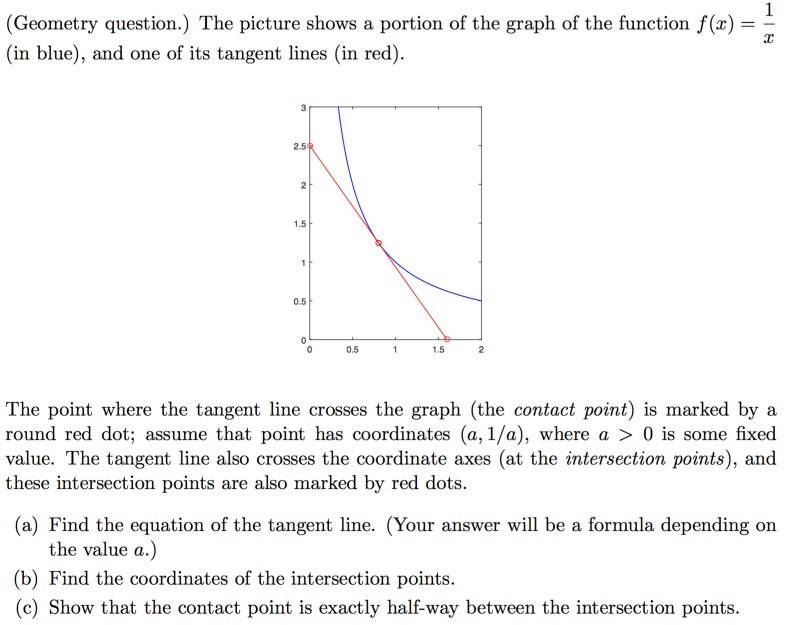

Hi Community,
I have this following tutorial question and I am stuck.
I understand how to take the derivative and find the tangent line at certain value for \(\displaystyle x\)
Which would say if \(\displaystyle x=2\) and the derivative of \(\displaystyle \frac{1}{x}\) equals \(\displaystyle \frac{-1}{x^{2}}\) then the slope would be \(\displaystyle y=\frac{-1}{4}x\)
I am unsure of how to work out the answer from \(\displaystyle a,\frac{1}{a}\)
Any help would be appreciated in helping me understand this.
Cheers Nemo
Hello, Nemo! :)
a) To get the equation of a line, all we need is a point on the line and it's slope. We know a point on the tangent line is:
\(\displaystyle \left(a,\frac{1}{a}\right)\)
And we know the slope of the tangent line is:
\(\displaystyle f'(a)=-\frac{1}{a^2}\)
Can you now use the point-slope formula to get the equation of the tangent line?
b) Once you have the equation of the tangent line, try expressing this line in the two-intercept form:
\(\displaystyle \frac{x}{u}+\frac{y}{v}=1\)
Since we know the points:
\(\displaystyle (0,v),\,(u,0)\)
are on the line...and these are the intersects.
c) Use the mid-point formula to show the tangent point is the mid-point of the two intercepts.

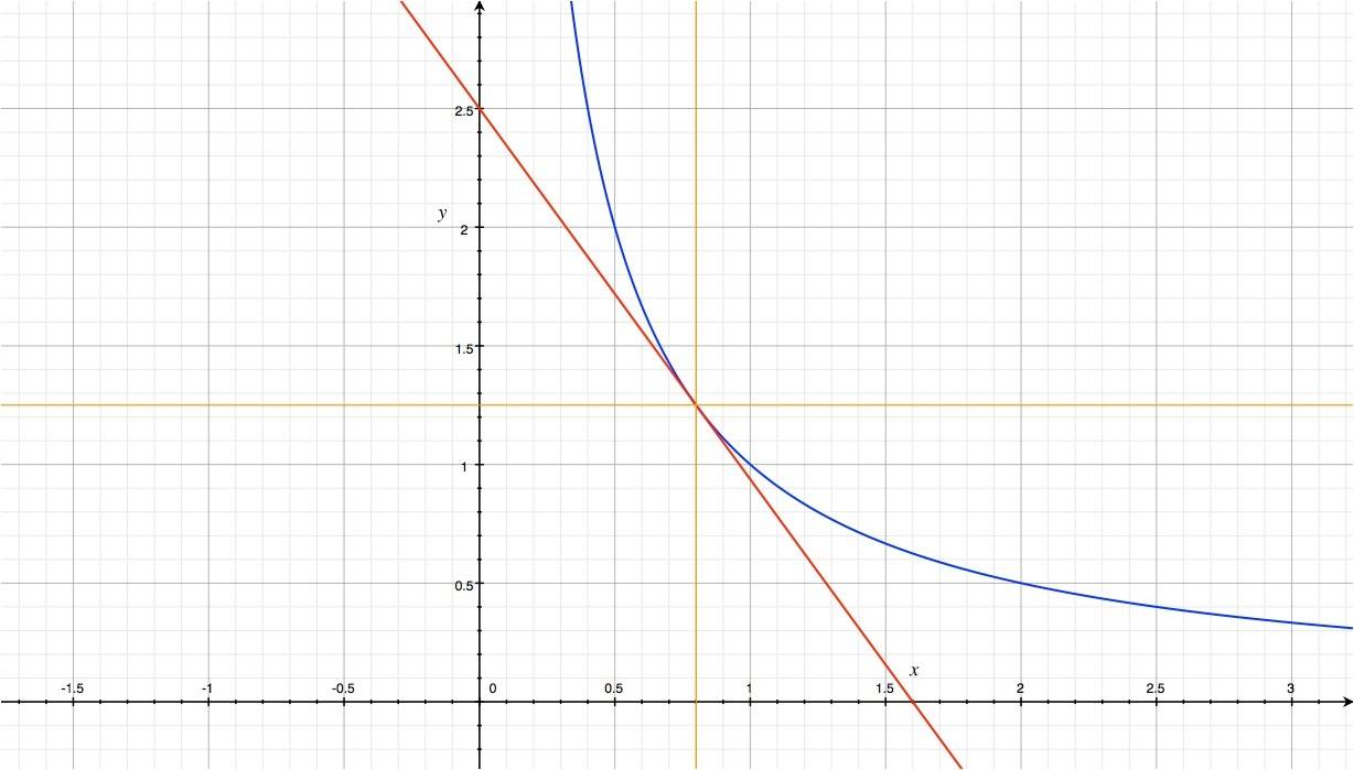

Ok, so I have been working thru this last section and have determined the following from Marks help:
First: The slope at the point \(\displaystyle \left(a,\frac{1}{a}\right)\) is the derivative of the $y$ $coordintate$ \(\displaystyle \frac{1}{a}\) = \(\displaystyle f'(a)=-\frac{1}{a^2}\)
Second: Using the Point-Slope Formula \(\displaystyle y=m(x-x_1)+y_1\)
We can plugin our slope from step one to get \(\displaystyle y=-\frac{1}{a^2}(x-a)+\frac{1}{a}\) simplified to \(\displaystyle y=-\frac{1}{a^2}x+\frac{2}{a}\)
Third: Converting \(\displaystyle y=-\frac{1}{a^2}x+\frac{2}{a}\) into the two-slope form \(\displaystyle \frac{x}{a}+\frac{y}{b}=1\) we get \(\displaystyle \frac{x}{2a}+\frac{y}{\frac{2}{a}}=1\)
So we know now our intercepts are \(\displaystyle \left(2a,0\right),\,\left(0,\frac{2}{a}\right)\)
Fourth: Using the mid-point formula \(\displaystyle \left(\frac{x_1+x_2}{2},\frac{y_1+y_2}{2}\right)=(x,y)\)
We get \(\displaystyle \left(\frac{2a+0}{2},\frac{0+\dfrac{2}{a}}{2}\right)=\left(a,\frac{1}{a}\right)\)
Fifth: Looking at the graph we know the $y$ $axis$ intercept is at $2.5$ or \(\displaystyle \frac{5}{2}\) in its fractional form or \(\displaystyle (0,\frac{5}{2})\) we can plug this into \(\displaystyle \frac{2}{a}=\frac{5}{2}\) and solve for $a$ and get \(\displaystyle a=\frac{4}{5}\)
Sixth: Now we know that \(\displaystyle a=\frac{4}{5}\) we can plug this into the original $x$ $intercept$ of \(\displaystyle (2a,0)\) to get \(\displaystyle (\frac{8}{5},0)\)
Seventh: We now have all we need to determine the Mid-point coordinates:
\(\displaystyle \left(\frac{\frac{8}{5}}{2},\frac{\frac{\frac{2}{4}}{5}}{2}\right)=\frac{4}{5},\frac{5}{4}\)
Graphing this I get the following:
Please let me know if I have made an error in my explanation, I find by explaining it back helps me learn and hopefully be able to apply these skills confidently to other new problems.
Cheers Nemo
+ Massive thanks to Mark!
Hello, Nemo! (Wave)
It's a genuine pleasure to help someone who is truly interested in gaining a better understand. (Sun)
The only thing I would add to in your review of the problem is your first point. When you say you are taking the derivative of the $y$-coordinate, it would probably be better to say you are taking the given function:
\(\displaystyle f(x)=\frac{1}{x}\)
And differentiating w.r.t $x$ to get:
\(\displaystyle f'(x)=-\frac{1}{x^2}\)
and then observing that the slope $m$ of the tangent line passing through \(\displaystyle \left(a,\frac{1}{a}\right)\) would be:
\(\displaystyle m=f'(a)=-\frac{1}{a^2}\)
While what you did works and is technically correct, I think it is more instructive to look at like this instead. But, we all have our own way of seeing things, and so you should feel free to develop your own style as long as it follows the rules of the calculus.
Nice graph, by the way. (Yes)
