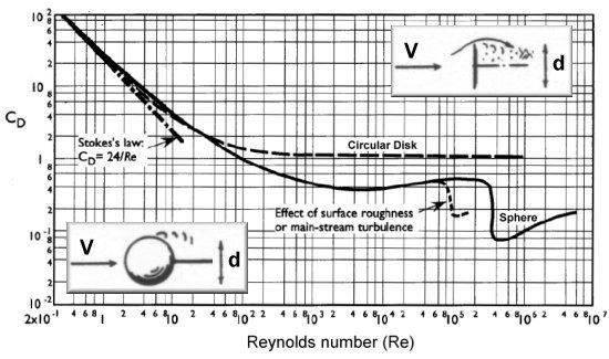

how does b depend on speed
For air resistance proportional to v^2 ,
The Eqn is $$F_R=\frac{dA}{2}v^2$$
F_R=Resistive force
d=Fluid density
A=surface area
So $$b=\frac{dA}{2}$$
Also what do you mean by add extra “dimensions”
That's complicate and depends on shape and surface properties. Here is an example for spheres and discs:
(The Reynolds number is proportional to speed.)
