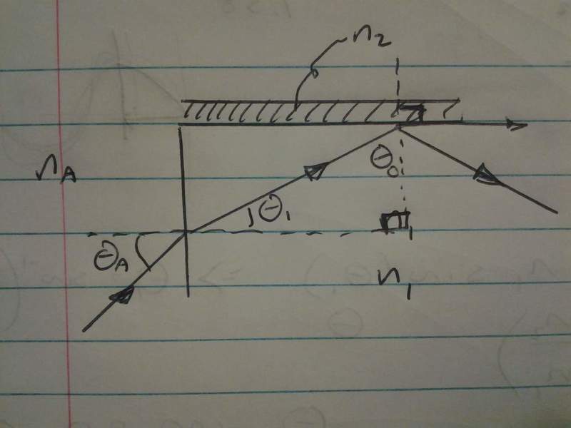

If a beam of light undergoes total internal reflection, are there any equations to determine the angle of reflection based on the angle of incidence?
Snell's Law: ## n_1sinA = n_2sinB ## is to my knowledge only valid under medium-to-medium transmission (for B: [0, pi/2]), correct? If total internal reflection occurs, is there an analogous equation to determine the angle of reflection in this case? I believe I saw previously that ## n_1sinA = sinB ## but I believe I took it out of context and am a little uncertain on how to proceed from here.

My main question essentially stems from here: https://www.physicsforums.com/threa...nternal-reflection-of-a-beam-of-light.715719/
It's just one step I'm having trouble understanding, and that's going from:
90 - θ1 > arcsin(n2/n1)
Substituting for θ1
90 - arcsin(sin(θa)/n1) > arcsin(n2/n1)
This substitution doesn't quite make sense from what I see. Although it's likely I'm just overlooking something right in front of me. :)

No shifting involved. It's as simple as [itex] \theta_i = \theta_r [/itex]. Again though, this assumes that the angle of incidence is large enough for total internal reflection to happen in the first place.

Without going through all the steps in the thread you quoted, realize that [itex] \theta_A [/itex] and [itex] \theta_1 [/itex] (see attached imagine in that thread) do not involve total internal reflection. Snell's law applies normally for those angles. On the other hand, [itex] \theta_0 [/itex] involves total internal reflection only if [itex] \theta_0 [/itex] is greater than the critical angle.
So the crux of the problem in that thread is finding [itex] \theta_0 [/itex] such that it equals the critical angle, and then translating that back to the corresponding [itex] \theta_A [/itex].
My point is that the problem in that thread does not actually involve total internal reflection at all, in particular; rather it involves the critical point at which total internal reflection fails.
Getting to the question you posed in that thread,
MathewsMD said:
It may be painfully obvious, but how exactly was θ1 = arcsin(sin(θa)/n1) derived?
Do you see how that is just a rehashing of Snell's law using different variable names such that
[tex] n_1 \sin \theta_1 = n_A \sin \theta_A [/tex]
where [itex] n_A \approx 1 [/itex] since it's air.

Thank you for all the help! So just to clarify, is it safe to assume that ## n_A = n_{air} ##? I was under the impression ## n_A ## is arbitrary and that is why I had trouble understanding the solution, but I guess it is somewhat justified when considering the very first beam IF it's entering from the air. (which it now appears he does show). Please correct me if I'm mistaken.

The problem statement in the that thread in question did say, "Suppose a beam of light enters the fiber from air at an angle [...]," then in the attached figure it labeled that angle as [itex] \theta_A [/itex] and index refraction of the air as [itex] n_A [/itex].
It's safe to assume that [itex] n_A = n_{air} = 1[/itex] for this particular problem (in the quoted thread) only. Only because it was written that way, specifying that the beam entered the fiber from air.
