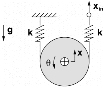

Thin uniform disk with radius r, mass m, and moment of inertia 0.5mr2 is suspended from a cable line where one end is attached to a set point via a spring, and the other end is also attached to a spring but is moving in an upwards direction. Solve for the equations of motion in terms of x(t) and θ(t).
http://imgur.com/xYwVP79
ΣF=ma, ΣT=Iα, Fs=kδ
Used Newtons 2nd law in terms of rotational and translational inertia. δ1 is change in length of left spring, δ2 is change of length of right spring.
Translational: kδ1 + kδ2 - mg = mx"
Rotational: -kδ1r + kδ2r = 0.5mr2θ"
I set δ1 = rθ and then I set δ2 = xIN-x
Substituted in and just rearranged each equation to have variables one side and constant terms on the other. Is that the correct way to work this problem? Thanks
just in case anyone comes across this... δ1 is actually x-rθ and δ2 is x+rθ... then ΣF=ma turns into -k(x-rθ) - mg + k(x_in-x-rθ) = mx". do the same for rotation and torques then solve
