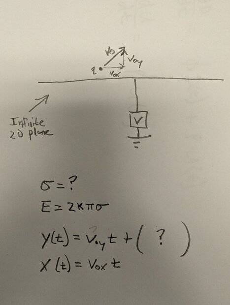

Here is a picture if that helps.
I answered this case in post #4. What is the force on the electron?

Sorry for the delayed response.
Assume r is the radius of the charged disk form which the electron is ejected (in reality it is a more complicated shape).
I don't know the answer. I want to solve the infinite plane problem first because it seems like the easiest problem. If the solution dictates that the electron does not travel far above (h << r) the plane then I know it was a reasonable assumption.
If the electron travels a great distance from from the plane (h >> r) I would model the plane as a point charge?
If h~=r then I have a much more difficult problem that has a non-trivial solution.
Does this approach seem reasonable?

Just to reiterate where I am in this problem. I know the field from a 2-D infinite plane is E = 2 k pi sigma. I don't know how to calculate sigma for an infinite plane held at a fixed voltage V. Can anyone assist with this?
With the field quantified, I expect the y-position to vary proportional to E t^2 (third equation, second term). Can I get some assistance with this second term?

I think I am asking a different question. I know the potential on the plane. I hook a power supply to the plane and set a voltage. I don't know the charge on the plane (sigma). How do I get from V (power supply) to sigma?
You can't connect the power supply just to the plane. You need to connect to something else the other terminal of the power supply. The charge on the plane will depend on the capacitance of the system plane + the something else.or the plane and the "ground".
The power supply will be referenced to ground (see drawing).
What I wrote gives you a way to relate the potential of the disc to its charge density.
The drawing is just a schetch of the principle. The actual charge desnity will depend on the actual sizes and shapes of the components. You cannot get it from general principles. It's the same idea as knowing the actual map of the potential in the system. If you know how thw potential changes from point to point you don't need the charge density.
