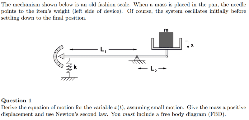

http://imgur.com/a/X7mWA
1. ΣF = m a
2. Στ = Iθ"
First , assuming small motion, all movement of the scale can disregard x components (so the spring stretches only in vertical direction without an impact from the x directional movement). I summed torque around the pin, point O, which would be equal to the mass moment of inertia * theta double dot. so...
mgL2 - kx1 = I0θ" (mass force positive since displacement is positive in the negative y direction)
x1 is the spring movement upwards, however we want to relate that to the x displacement downwards with the mass, which we'll just call x. Now, using like triangles, x1=(L1/L2)x. Then I know x = rθ, differentiate with time twice to get x" = r θ" so then θ" = x"/r, where r = L2. Now we have ...
(I0/L2)x" - k(L1/L2)x= mgL2 ===> (I0)x" + k(L1)x = mgL22
This answer just doesn't feel right. I feel like I may not have correctly applied Newtons 2nd law or maybe didn't correctly set up the kinematics. Any input would be helpful, thanks.
You need not take into account the mass moment of Inertia of mass m, since it is a statics problem
OK up to here.
Now we have ...
Check your math, this has at least 2 mistakes in it. One is a sign error.
Also, what is I0? You need to express this in terms yuu were given.
Also BTW not only is this not a static question but, contary to the problem statement iself, the scale swings forever back & forth since no damping mechanism was introduced.
