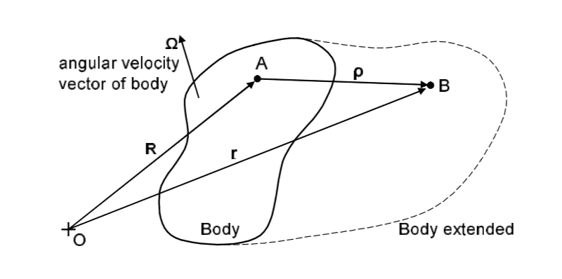

Hi,
I am just writing a post to follow up on a previous thread I made which I don't think was very clear. The question is mainly about how to use the below equations when there is also a rotation of the body around the fixed reference point.
Please see the diagram here to see how the vectors have been defined:
We can then derive the following equations of motion:
$$ r = R + \rho $$
$$ \dot r = \dot R + (\Omega \times \rho) + \dot \rho $$
$$ \ddot r = \ddot R + \ddot \rho + 2(\Omega \times \dot \rho) + \dot \Omega \times \rho + \Omega \times (\Omega \times \rho) $$
However, what happens if there is also a rotation of A around O (lets say that the angular velocity is ## \omega ##)? How do we now use the equations to find the absolute velocity and acceleration of B?

Does ## \dot R ## include the rotation of point A around O and therefore become ## \dot R = (\omega \times R)##? I originally thought that vector only included a linear translational velocity...
Now for the other two terms, one problem I was working seems to suggest that the rotation of B around point A is included in the ## \dot \rho ## term and not the ## (\Omega \times \rho) ## term. Therefore, it suggests that ## \dot \rho = (\alpha \times \rho) ## where ## \alpha ## is defined as above. It also suggests that ## (\Omega \times \rho) = (\omega \times \rho) ##. I am struggling to understand why this is the case.
Acceleration:
The equation is:
the ## \ddot R ## term contains ## \omega \times (\omega \times R) + \dot \omega \times R ## (it would also contain any linear relative acceleration but there is none).
the ## 2(\Omega \times \dot \rho) ## is the Coriolis term which is ## 2(\omega \times \dot \rho) ## where ## \dot \rho ## has been calculated above. This term makes sense to me.
the ## \ddot \rho ## term contains the ## \alpha \times (\alpha \times \rho) + \dot \alpha \times \rho ##
the ## \dot \Omega \times \rho ## term is ## \dot \omega \times \rho ##
the ## \Omega \times (\Omega \times \rho) = \omega \times (\omega \times \rho) ##
I am also struggling to see why the last two terms relate ## \omega ## and ## \rho ##.
Any correction/ clarification is greatly appreciated. In the lecture notes, we only saw situations with ## R = 0 ## and body just rotating around a fixed point, so this is new to me.
Thanks

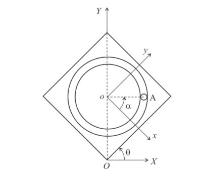

Thanks for your response @FactChecker . However, I found a diagram for these types of problems:
and this question asks us to find the absolute velocity and acceleration of A. We are given the distances, ## \theta##, ## \dot \theta ##, ## \ddot \theta ##, ## \alpha ##, ## \dot \alpha ##, and ## \ddot \alpha ##. In this situation we need to consider both rotations together and the solution uses the same method as above.
For example, the acceleration is equation is turned from
into
$$ a_A = a_o + 2 \dot \theta \times v_{A/o} + \ddot \theta \times r_{A/o} + a_{A/o} + \dot \theta \times \dot \theta \times r_{A/o} $$
and am confused why ## \dot \theta \times \dot \theta \times r_{A/o} ## appears in the equation. The terms like ## \dot \alpha \times \dot \alpha \times r_{A/o} ## are contained within ## a_{A/o} ##

If you rearrange the term ##a_{A_0}## in the second equation, then the two equations are$$\ddot r = \ddot R + \ddot \rho + 2(\Omega \times \dot \rho) + \dot \Omega \times \rho + \Omega \times (\Omega \times \rho) $$
$$ a_A = a_o + a_{A/o} + 2 \dot \theta \times v_{A/o} + \ddot \theta \times r_{A/o} + \dot \theta \times \dot \theta \times r_{A/o} $$
Each term in the second equation equals the corresponding term in the first equation.
Note that ##\Omega## in this picture
corresponds to ##\dot \theta## in this picture
The square plate corresponds to the "body" in the first picture. The angular velocity of the square plate relative to the inertial frame XOY is ##\dot \theta##, and this corresponds to ##\Omega## in the first picture. The particle A in the second picture corresponds to the particle B in the first picture. The point o in the second picture corresponds to point A (fixed in the body) in the first picture. Point O in the second picture corresponds to point O in the first picture.
Likes Abhishek11235 and Master1022

Thank you @TSny very much for the explanation! Can you explain what the physical interpretation of the ##\dot \theta \times \dot \theta \times r_{A/o} ## term is? It looks like a centripetal-type of acceleration term, but I am not really sure how to explain it in words.
Yes, this term is a centripetal-type acceleration. Suppose the particle A is not moving relative to the plate, so A is at a fixed location on the circular track and ##\alpha## is not changing. The particle will still experience acceleration due to the rotation of the plate about the corner O. The centripetal part of this acceleration is ##\dot \theta \times ( \dot \theta \times r_{A/O} )##. Write ##r_{A/O}## as ##r_{A/O} = r_{o/O}+r_{A/o}##. The acceleration is then
##\dot \theta \times \left( \dot \theta \times ( r_{o/O}+r_{A/o}) \right) = \dot \theta \times ( \dot \theta \times r_{o/O} ) + \dot \theta \times ( \dot \theta \times r_{A/0} ) ##
The last term on the right is the term you are asking about. The first term on the right is contained in ##a_o## in the overall expression
$$ a_A = a_o + a_{A/o} + 2 \dot \theta \times v_{A/o} + \ddot \theta \times r_{A/o} + \dot \theta \times (\dot \theta \times r_{A/o} )$$

@TSny - thank you once again, that makes much more sense now! I haven't been able to find such a clear explanation anywhere else.
Thanks
Ok. Glad I could help.
