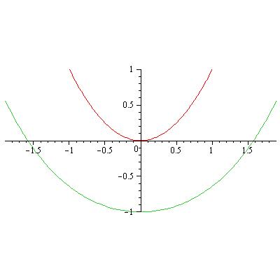

Since this isn't the OP's question, I will give a bit more suggestion to you. Let's write the parabola in vector form ##\vec r(t) = \langle t, t^2\rangle##. A tangent vector is ##r'(t) = \langle 1,2t \rangle## and a unit normal pointed down is ##\hat n(t) =\frac 1 {\sqrt{1+4t^2}}\langle 2t,-1\rangle##. Now let's say you want a parallel curve ##h## distance from and below the parabola, use$$
\vec q(t) = \vec r(t) +h\hat n(t)$$Here's a picture with ##h=1##:

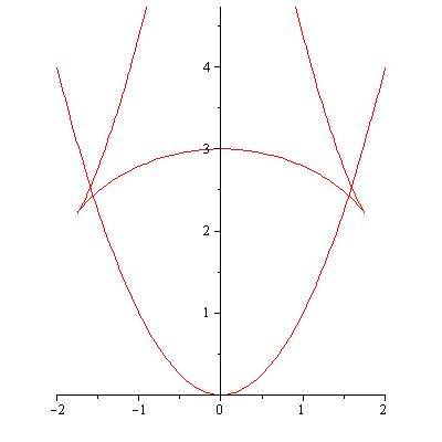

I don't think you will have much luck with that in general. For example, if you take the parabola ##y = x^2## and look for the curve that three units away and parallel "above" it, that is too high to fit above it near the vertex and you get a graph that looks like this:
The equation for that is$$
\vec R(t) =\langle t - \frac{6t}{\sqrt{1+4t^2}}, t^2 - \frac{3}{\sqrt{1+4t^2}} \rangle$$I haven't tried it, but looking at the image I'm guessing if you manage to put this in the ##y = f(x)## form, it won't be either simple or and some "standard" form you would recognize. It gets even more interesting if you do the same thing to an ellipse and put the second curve too far on the inside.
