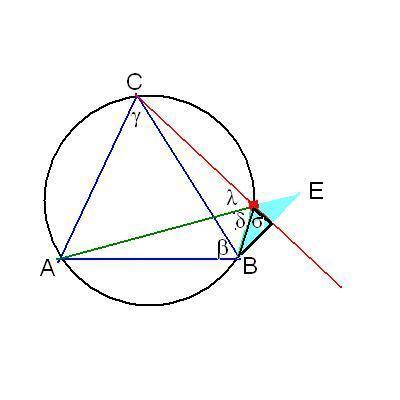

I figured all the angles. What next?
Try to determine the angle ADE. (First find the angle of the blue right triangle at D.

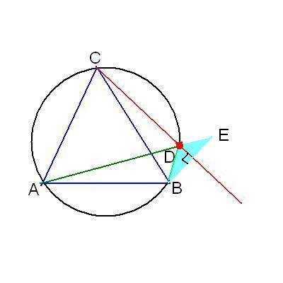

Calculated the angles of the blue triangle.
Help ! "D l
You have to prove that ADE is a straight line, that is, the angle ADE is 180°. What are the angles ABC, ADC ADB,?
The red line CD halves the blue triangle, as it is symmetric to the red line. Wjhat are the angles at D?

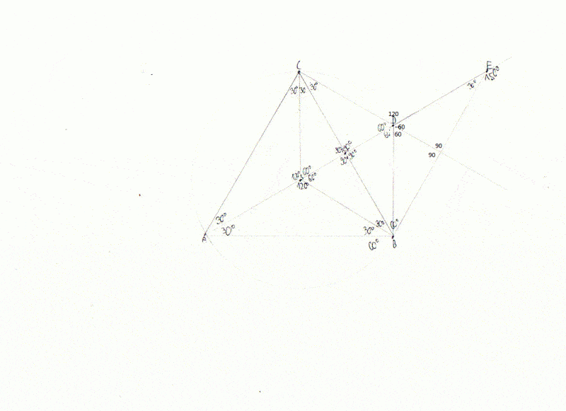

All I calculated.
I can't write request.

Show what you calculated. What are the angles γ and δ; β and λ? How many degrees? What is the angle σ?

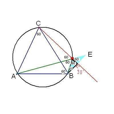

Already pasted.
You seem to be assuming that the line drawn from A will intersect BC at a 90 degree angle. This is incorrect.
In post #2, ehild said to use the law of inscribed angles. Check that out and see if you can find all the angles in terms of the one variable angle.
@dawo0: your drawing does not help to solve the problem. It shows the special case when the point D is at the middle of the arc BC. But you need to prove the statement of the problem for any point D on the arc.
You have drawn ADE as a straight line, but you have to prove that it is a straight line!
Do you understand why are γ=δ=60°and λ=β=60°? You should explain. In general, you should explain your statements when solving a problem.
Something like that: β is one angle of the equilateral triangle, so it is 60°. β and λ are inscribed angles of the circle, belonging to the same arc AC, so λ=β...
