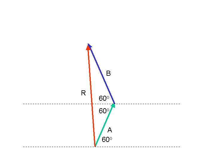

Three point charges of +2μC, +3μC and +4μC are at the vertices of an equilateral triangle ABP, respectively, having sides of 10cm. What is the resulting force R acting on the +4μC charge?
the hint in class is to use the law of cosines
this is how i set it up
force acting on 4uc from 2uc =
(9*10^9 N^2*m^2/C^2)(4uc)(2uc)/(.10m)^2
=7.2 N
force acting on 4uc from 3uc =
(9*10^9 N^2*m^2/C^2)(4uc)(3uc)/(.10m)^2
=10.8 N
now here is where I'm kinda confused i don't entirely see how to use the law of cosines here
from the information i found out that the angle between the resultant of 7.2 and 10.8 = 48.2
by using cos(theta) = 7.2/10.8
then i used C^2 = A^2 + B^2 - 2ABCos(theta)
C^2 = 7.2^2 + 10.8^2 - 2(7.2)(10.8)(Cos48.2)
C= 8.05 N
C= resultant vector
but my teacher says the answer to the problem is 15.7N
what have i done wrong?

OK. What direction does it have? (Let A & B be on a horizontal line, with P above it.)
=10.8 N
OK. Again, what direction does it have?
To add the two vectors, draw a triangle. Use the law of cosines to calculate the resultant (which is one side of the triangle).
Not sure what you mean, but the angle between those two vectors is not 48.2 degrees. (Draw a picture.)
Hint: Find the angle between the two vectors by drawing a careful diagram. That's the angle you will use in the law of cosines. (What are the angles in an equilateral triangle?)

Did you actually draw a diagram like I asked? One vector makes an angle of 60 degrees with the horizontal. Now when you add the second vector, which also makes an angle of 60 degrees to the horizontal but slants in the opposite direction, the "triangle" formed has 120 degrees between the sides. (The sides of that triangle are the two vectors you are adding.) You must draw this. Do not settle for a lucky guess.

I suspect that something is wrong with how you are drawing your diagram. In any case, rather than going by what the angle on your diagram looks like, use geometry to figure out what the angle must be.
I drew a quick (not to scale) diagram showing the triangle formed when adding two vectors:
[tex]\vec{R} = \vec{A} + \vec{B}[/tex]
You are trying to find the resultant, which is side "R" of the triangle. Convince yourself that the angle opposite that side--which is the angle used in the law of cosines--equals 60 + 60 = 120 degrees.
(Using the law of cosines is only one way of finding the resultant. But since your instructor brought it up, you may as well learn it.)
