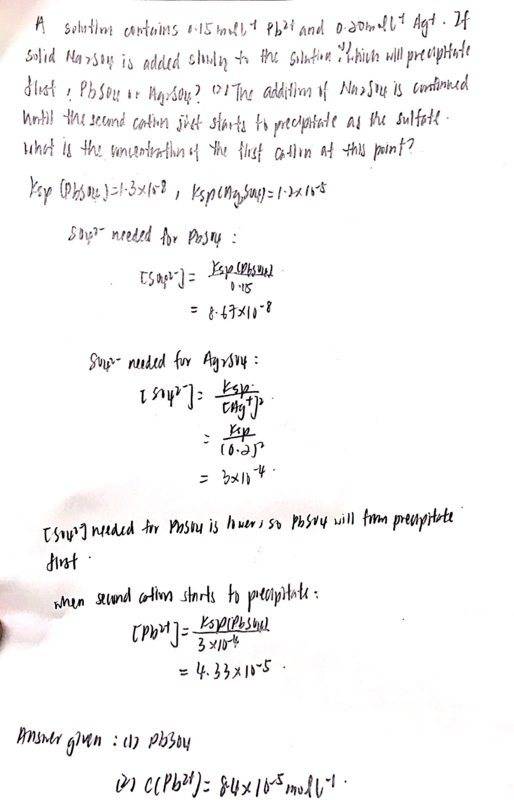

Calculate the concentration of the first cation until second cation just starts to precipitate as sulfate
Ksp
I got the first question correct but I don’t understand the answer given for second question which is c (Pb^2+) = 8.4x10^-5 molL ^-1. It divided the concentrate for sulphate ion of Ag2SO4 into 2 , but it is the solubility right ?

This is very difficult to read :mad:
As far as I can tell - it didn't.
My answer is 4.33 x 10^-5, but answer given is 8.4x10^-5, how can I get it?
Next time please type the answer (takes less time than writing and taking pictures).
As far as I can tell answer given is wrong, your approach looks OK.
Sorry, my computer have problems that time, I can just upload using phone. Therefore, is it the given answer is wrong?
Looks like, I got the same answer you did.
Likes daphnelee-mh
Were you given the Ksp for PbSO4?
Wikipedia has it at 2.13X10^-8 (20C), the CRC has it at 1.06X10^-8 (18C) and you are using 1.3X10^-8!
