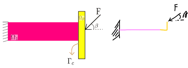

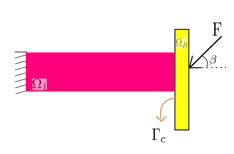

Consider a structure comprising an elastic deformable body (in pink) attached to a rigid body (in yellow) at the right side ( $\Gamma_c$ interface) and fixed at the left side.
Assume a force $F$ is applied to the rigid body at an angle $\beta$, as shown in the diagram. Subsequently, the deformable body undergoes deformation. (By the way, the elastic and rigid bodies stay together even when the force is removed)
What are the equilibrium conditions for the rigid body?

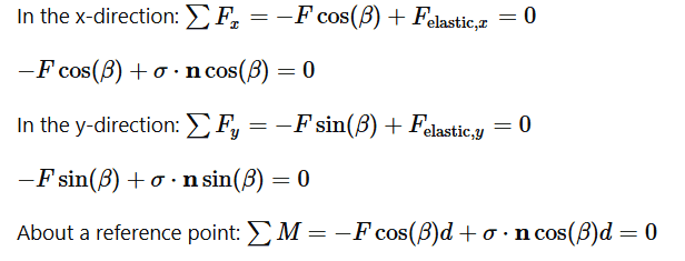

I think that it is expressed as follows:
rich text editor image
where
$\sigma$ is the stress of the elastic body and $d$ is the perpendicular distance from the forces causing moment to the reference point which is taken to be the bottom point of the left corner of the rigid body.
Note:
  • x-axis is taken as the horizontal axis and y-axis as the vertical axis.
  • the cantilever is allowed to deform and to rotate while staying attached to the rigid body.
I'd like to know whether the equations I wrote are correct?

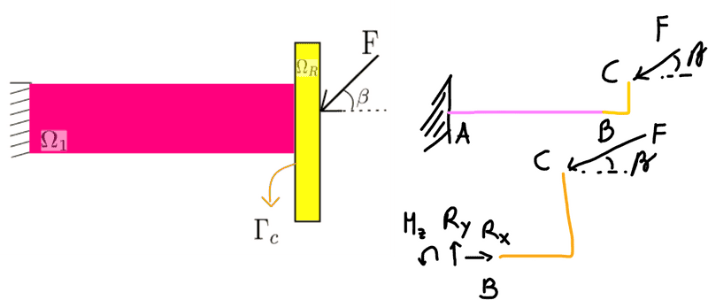

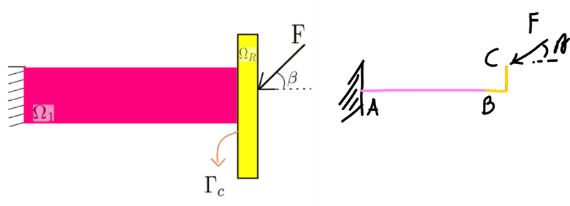

How complicated do you want to make this? Seeing ##\Omega## to describe a body brings nightmares from the past to me.
I'd assume beam equations if you're all right with a simple approach. That is, the pink body is treated as a 1D body represented by its neutral line along its length. That implies the forces and torques done by the pink body on the yellow body are at the point where they meet.
(They only meet at a point because it's a 1D body)
Notice I shaped the yellow body as an L to take into account the possible misalignment with the neutral line of the pink body. Take into account that the shape of the yellow body isn't relevant. I'd have drawn it as an inclined straight line from B to C and the net effect would be the same.
Finally, to find the reactions / internal forces at point B, you have to study that joint as a fixed link capable of transmitting forces and torques.
The forces and torques at B can be translated into the stress in the pink body at that point if you're interested in that. Knowing the reactions at A and B you can find the stress state of the pink body using beam equations.
On the other hand, if you're trying to solve it through a General 3D Elasticity approach the problem becomes way more complicated, and most likely there isn't an analytical solution to it. That's one of the reasons FEA is so widely spread.

Are the balance equations I have mentioned in my question correct?
I don't think so.

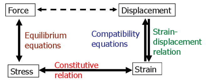

In elasticity, there's the relation between forces and displacements. That is initially introduced as ##F = -kx##.
However, in general elasticity, that becomes significantly more complicated. The relation is still true in the way that displacements are proportional to forces but it's necessary to take a detour.
Picture source
I haven't read the link in detail myself because I was only interested in the picture.
How familiar are you with the diagram I showed?

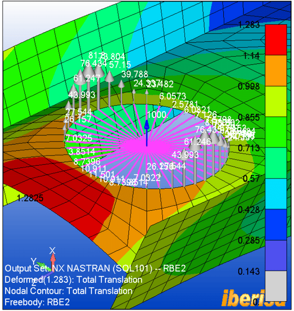

What's your FEM software? With a computer, the problem becomes almost trivial. It's a matter of correctly defining the boundary conditions. The software will translate that into the necessary equations and solve them by itself.
Regarding the yellow rigid body, you just need to tell your software that the nodes attached to the yellow body will remain undeformed. In FEMAP-Nastran that's what's usually called an RBE2. Using a RBE2 it's possible to apply the force at a distant node so the possible introduction of torques will be correctly computed.

For the overall force balance in the x-direction, I get $$F_{Ax}=F\cos{\beta}$$where ##F_{Ax}## is the x-direction reaction force component on the beam exerted by the cantilever support at A.
For the overall force balance in the y-direction, I get $$F_{Ay}=F\sin{\beta}$$where ##F_{Ay}## is the y-direction reaction force component on the beam exerted by the cantilever support at A.
For the overall moment balance centered at A, I get $$M_A=F\sin{\beta}L$$where ##M_A## is the counterclockwise moment at A exerted by the cantilever support at A on the beam, and L is the total length of the beam.
The moment balance for the section of the beam between A (x = 0) and arbitrary location x, I get $$M_A-xF\sin{\beta}=M(x)$$where M(x) is the clockwise moment exerted by the part of the beam beyond x on the part of the beam up to x, or $$M(x)=(L-x)F\sin{\beta}$$From the beam bending equation , we have $$EIy''=-M(x)=-(L-x)F\sin{\beta}$$subject to the boundary conditions ##y'=y=0## at x =0.
Likes Juanda, Mechanics_student and Lnewqban
It seems that your diagram is missing important information.
Could you please define the n and d variables in your equations?
What is the exact point of application of the force on the yellow rigid body?
How are those equations applicable to the equilibrium conditions for the rigid (yellow) body?

Equilibrium of the yellow body can be found as previously stated.
For that, you're missing some key information as mentioned by @Lnewqban.
The application of beam theory from @Chestermiller at #9 is correct too assuming that the horizontal component of the input force ##F## is aligned with the neutral line of the pink beam so it doesn't introduce an additional torque on the system.
(There is the topic of introduced torques once deformed but that's a whole different story)
I think all the questions you (@Mechanics_student) had are now clear. Solving this problem from a General Elasticity point of view is way more complex and doesn't seem to be the objective of the exercise.

Ok so, the original problem is that the elastic body is piezoelectric. And no only that, it is a bimorph. It is about optimization but taking into account the applied force. It is a big problem but my professor was only commenting on the equations regarding the rigid body (equilibrium) so he asked me to correct them.

Do these equations make sense for example?
$$\sum F_x = 0 \quad \Rightarrow \quad F_x - \int_{\Gamma_c} \sigma_x \, dA = 0$$
$$\sum F_y = 0 \quad \Rightarrow \quad F_y - \int_{\Gamma_c} \sigma_y \, dA = 0$$
$$\sum M = 0 \quad \Rightarrow \quad F_y \cdot d_x - F_x \cdot d_y - \int_{\Gamma_c} (\sigma_x \cdot y - \sigma_y \cdot x) \, dA =
0$$
Picture source
0$$
If I were you I'd try the approach given in previous posts using beam theory / strength of materials.
In most cases, the results are accurate enough.
Beam theory is already capable of going from the loads on the line to the stress fields on the body.
The equations you have by themselves don't contain enough information to be solved because you don't know the pressure distribution between the pink and yellow bodies.
(Besides, I'm not sure about your equilibrium of torques equation because the diagram is not clear to start with)
Physically describing reality can be as complex as you want. It's best to start with a simple model and see if that's enough for your task. Taking into account that you seem to be struggling, I don't think you're ready to try to tackle this from a general elasticity point of view unless you're using modeling software that simplifies the task for you.
Likes Mechanics_student and Lnewqban
The 2D equations should include:$$\frac{\partial \sigma_{xx}}{\partial x}+\frac{\partial \sigma_{xy}}{\partial y}=0$$$$\frac{\partial \sigma_{xy}}{\partial x}+\frac{\partial \sigma_{yy}}{\partial y}=0$$The above are the stress-equilibrium equations.
u = v = 0 at x=0
##\boldsymbol{\sigma}=0## on the free surface
##\sigma_{xx}A=-F\cos{\beta}## at x = L
##\sigma_{xy}A=-F\sin{\beta}## at x = L
plus the strain displacement equations and Hooke's Law in 2D

Juanda said:
Because continuous mechanics is a pretty hard topic.
u = v = 0 at x=0
However, wouldn't there be an additional boundary condition forcing the end of the pink beam to keep its shape because it's fixed to a rigid body?
Or maybe not consider it fully fixed if it's just pushing it but at least its rotation should be linked. I'm trying to say it allows for expansion due to the Poison ratio, but the line should remain straight even if it becomes inclined.
Juanda said:
Not the kind of software I had in mind for sure.
I guess there really are Python libraries for everything.
I'll probably try to solve it myself too using the equations and boundary conditions provided by @Chestermiller at #20.
Yes. The equations for the stresses at L should involve integrals over the area rather than stress times area, and there should be a kinematic condition requiring the ratio of the displacements to be constant. ##u=kv##

Thank you! The displacement should be zero at the fixed end (at the left) because of the fixed support and also no rotation is allowed at the fixed support
##u## is the displacement along x-axis and ##v## is the displacement along y-axis?
That's true. I was talking about the rightmost end though. See post #25 for more details. You can see how ##u=kv## corresponds to the equation of a line because that end will remain straight since it's fixed to the straight rigid body. If the rigid body turns (and it should turn according to the fixation at A and the input forces at L), the pink body will turn with it similarly if we consider them fixed.
Do I also perform inner product of stress with the normal vector of the surface when I integrate the stress over the area?
  • #31
Of course

If I name the area as ##\Gamma_c## then it could be written this way ?
