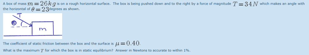

see attached
0=Tsin(angle)+Ff
So I already know the normal force is 268.08 from a previous part of the question. I thought that the friction force must be less or equal to uFN for an object to stay in static equilibrium.
So Tcos(angle)=uFN
T=uFN/cos(angle)=116.49
But the answer is suppose to be 133.37.
But the normal force depends on the force ##T## which is an unknown.
T isn't an unknown. T=34
Isn't the value T = 34 N used for a previous part of the problem? In the part of the problem that you are now working on, you are looking for the maximum value that T can have before the block starts to slide. So, the value of T that you are looking for is unknown. You cannot assume that the normal force is the same in both parts of the problem. As T is increases, N increases.
Likes JoeyBob
So FN=mg-Tsin(angle).
Ff=umg-uTsin(angle)
0=Tcos(angle)-umg+uTsin(angle)
T=umg/(cos(angle)+usin(angle))
This gives me 94.65, which is still wrong.
Check the signs in this equation. Otherwise, things are looking good.
Likes JoeyBob
Thanks
